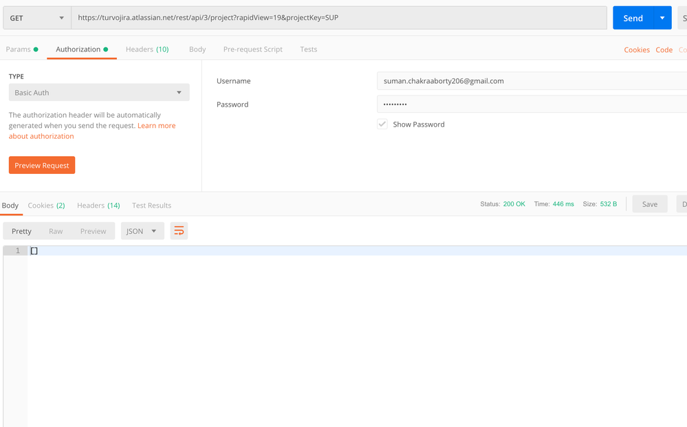

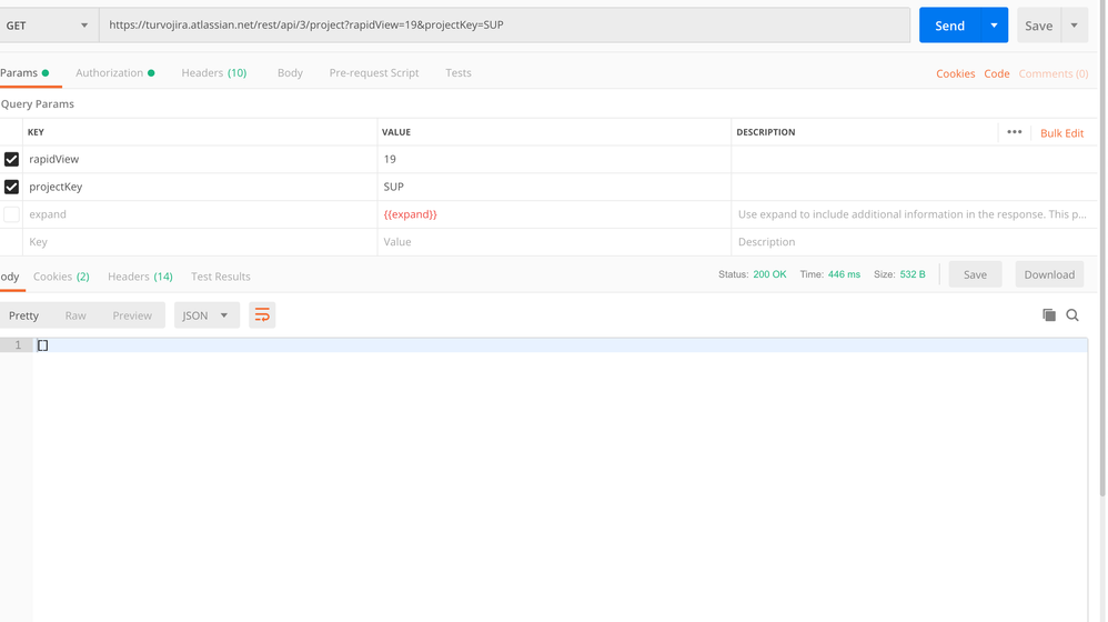

I was trying to fetch the data of my projects so that I can create report out of it .
Somehow it not going through .
For example:
https://{{host}}/rest/api/3/project/:projectIdOrKey?
I am using the above api after replacing the host and also using my credential and trapidView=19&projectKey=SUP .
But the result is coming blank .
Don'Screenshot 2019-06-17 at 7.09.33 PM.pngScreenshot 2019-06-17 at 7.09.42 PM.pngt know why
Aleksandr Zuevich
June 17, 2019
This is because you try to use query parameters instead of path variables. In your case you should use this URL: https://turvojira.atlassian.net/rest/api/3/project/SUP

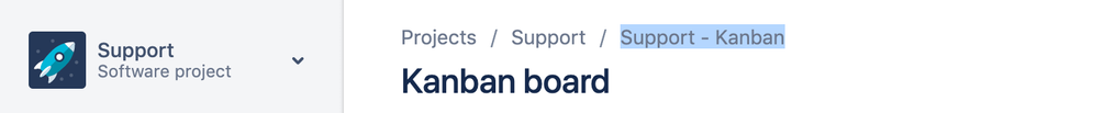

Screenshot 2019-06-17 at 10.55.38 PM.pngCan you suggest what should if I want to get Support - Kanban board
Aleksandr Zuevich
June 17, 2019
To get the board you can use https://turvojira.atlassian.net/rest/agile/1.0/board/19
