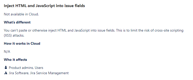

I read that it is possible to put JS/HTML in issue fields, but it seems that wont work on cloud (see image). We are presently on server but moving to cloud because it is more  restrictive ;-)
So at the moment i have run out of ideas again.... :-(
