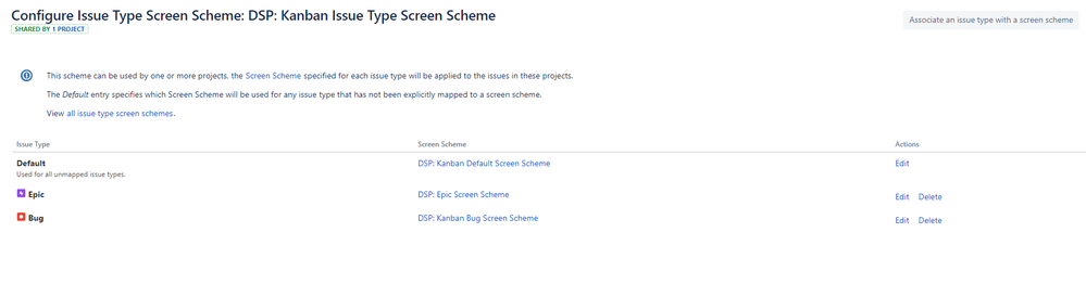

In order to understand what's going on on your project you could go to:
cog wheel > issues > issue type screen scheme (ITSS)
and locate your project's scheme. From the screen below you will see the screen schemes that each issue type is using.
issuetypescreenscheme.pngE.g. from the above picture you see that Epic is using a different screen scheme from that of Bug, whereas all other issue types (not visibile/mapped on that ITSS) are using another screen scheme.

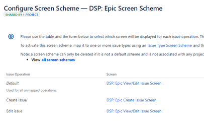

Clicking in any screen scheme from that picture you will see the issue screens used for each issue operation (create, edit, view). E.g. for the epic I have used 3 different screens for these three operations, because I want to have different fields on each issue operation:

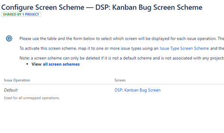

However, on the Bug I'm using only one screen for all three operations:

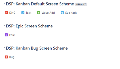

Going into my project I can see the above view if I go to project settings > screens:
So from the above picture I can undestand that Epic and Bug use a different screen scheme, independent from each other, whereas all other issue types (DNC, Task, Value Add and Subtask) use the a common (but different) screen scheme.
