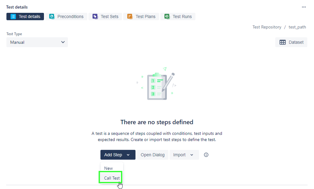

2. if it doesn´t need to be in the pre-condition section but you want to have your login test case in another test case as well I suggest to use the "call test" function in your test step section. You could then just add your login test case to the test step section of other test cases (see screenshot below).
Hope this is helpful.
