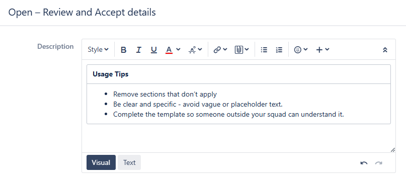

My business owner wants to know if I can change the title of the screen that appears in a workflow transition, whilst still keeping the transition name.

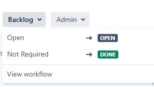

From the Backlog step to the Open step the name of the transition from the Action button should rename Open, however the screen in between is where my business owner wants to title the dialog as "Open - Review and Accept details"

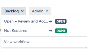

I have tried adjusting the workflow property jira.i18n.title to "Open - Review and Accept details" however this has now adjusted the transition name on the action button

The ideal presentation would have the action button adjusted accordingly and keep the screen title

This as mentioned by @Tomislav Tobijas "Screen name/title on the transition = transition name. I think that jira.i18n.title property is shared with both entities" is indeed the same.
On your requirement, this is not possible.
If you use a screen on a transition, the title shown on the screen is identical to the transition name, so the property can adjusts the title, but this impacts both.

Screen name/title on the transition = transition name. I think that jira.i18n.title property is shared with both entities, meaning that when you update it, it will reflect on the dialog title and the button text simultaneously.

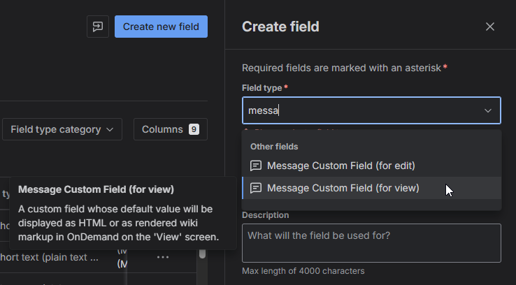

You could tweak it a bit by using Message field and putting some custom text there, but the title of the dialog would still be the same.

I think the Message field exists for Cloud only. (or its in a data center version we have not published yet)
I will look into the possibility of a mimicking that feature with a read-only text field.

Ah, interesting... Might have mixed this up then, as I know we did one migration from DC to cloud, and we used this field, but it might be that it was additionally created on cloud, after migration.
Would be worth checking if something like that is available on DC (also might depend on the DC version you have), but some kind of workaround should be possible.
