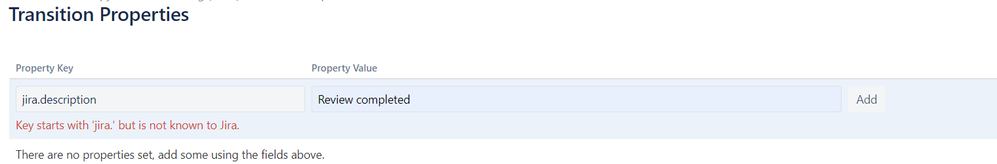

Hi Team,
We are doing migration from server to cloud. during these we facing problem in workflow transition properties.
" 1) jira.description , 2) jira.fieldscreen.id "  these transition properties are present in jira server but we are getting error while configuring in cloud.
I have share Screenshot with you.
Please check it out and give solution over it.
Thanks and Regards,
Prathamesh Rane

Hi, @Sanjen Bariki Yes ........You are right,  In server to cloud migration worlflow properties are not migrated, thats why I am doing that manually. but I am getting one error over there.
Could you please take a look at this, and let me know any solution there for cloud?

Hi @Prathamesh Rane ,
Could you please check in the server, Are you putting the properties value correctly..?
In workflow properties, you can add the below properties in cloud and I can't see the Description value.
If you change the value jira.description to Jira.description  It may not work, Please try it and let me know.
