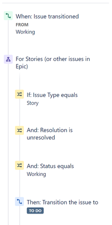

Hi @Aisha M
Yes this can be done using an automation rule (see below)
So when a task is moved from WORKING > [any other status], IF said task is an epic issue type, then for all unresolved stories within that epic which are in a status of Working, they will be transitioned to To Do.
Hope this helps!

@Aisha M Yeah that's correct, I actually tested out this rule before posting and here's what it looks like:

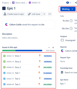

Epic and 2 of it's stories are in status WORKING

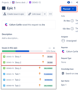

After Epic is transitioned to something else (in this case, PLANNED), ONLY it's 2 stories in WORKING are transitioned to TO DO, all other stories/tasks remained unchanged:
@Callum Carlile _Automation Consultants_ Just a random question regarding the JIRA project automation, why does the Project Automation always require the page to be refreshed in order to reflect the change ?
Example - When I move my Epic to an upstream status, the associated Story that is displaying on the Epic page doesn't show the change right away . I'll have to refresh the page & then the Story on the Epic page reflects the change . . . Very weird

Hi @Aisha M Are you sure it was me ? This is the first time I open this question :o
Anyway yes this is probably possible with a script. To be honest the above solution with automation seems just fine. Either way the "visual" of the status is not refreshed automatically. Automation or scriptrunner, you will have to refresh the page to see the new status.
