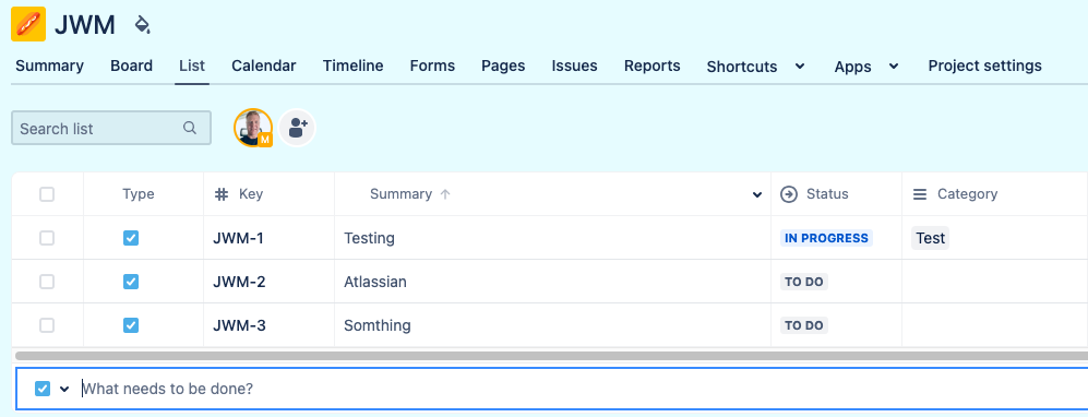

Each contract would be its own issue in JWM, and you could do a bulk import so that you do not have to manually input all of them. Visually it would looks something like this:

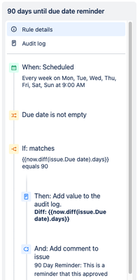

Is there an instruction somewhere on how to do this?  I am not finding a way to set this up so I can use dates.
Mikael Sandberg
November 20, 2023
You can use the due date to do this, and then the automation would look something like this:
