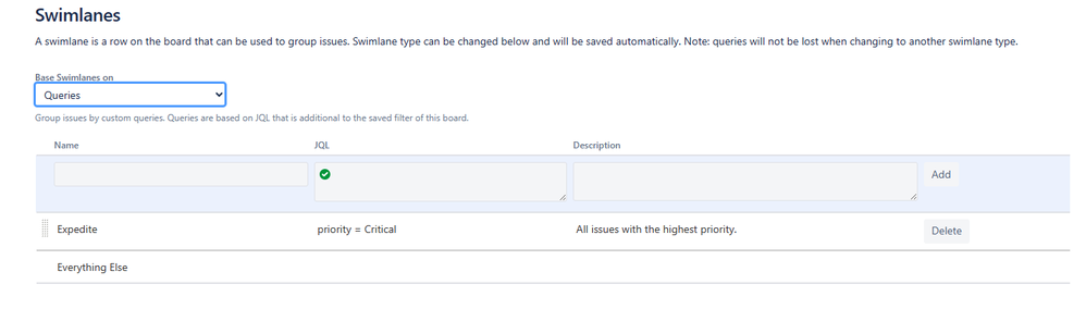

What is shown on the Sprint board is controlled by the filter you set so you could have two different boards with different filter results.
I think the best case, however, is to keep everyone in the same board, if you can, to avoid the scenario where things can get lost. You can have, for example, different swimlanes to keep things separate but visible -
