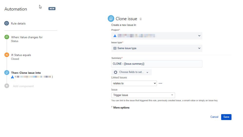

Sedera Randria
October 21, 2020
Hi @Anabel Hurtado ,
Have you already played with the Automation feature?
Does it help you to build your solution?

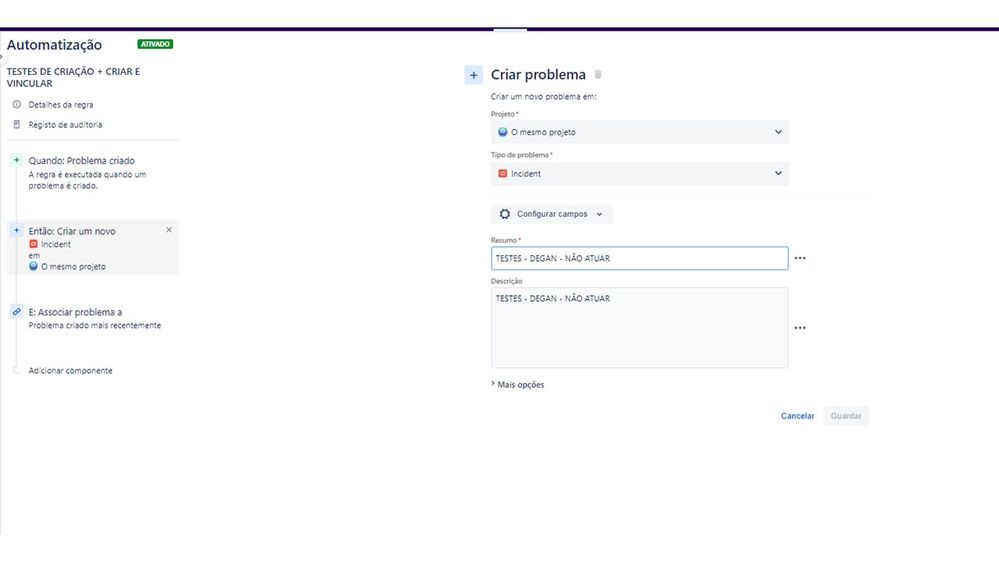

Henrique Degan
October 21, 2020
Hello,
In this case you are wanting to create a ticket after creating a certain ticket is that it?
Would it be a POST or would you like to update the ticket created as well as a PUT?
If you are creating and linking you can do it in the following steps:
CREATE + WHEN PROBLEM CREATED + ACTION + CREATE PROBLEM (Here you define how in which issue setra created etc ...) + ACTION + AND ASSOCIATE PROBLEM (Choose type of association and in Problem put the most recent Problem created), so he will associate the problem created.
Hope this helps.
