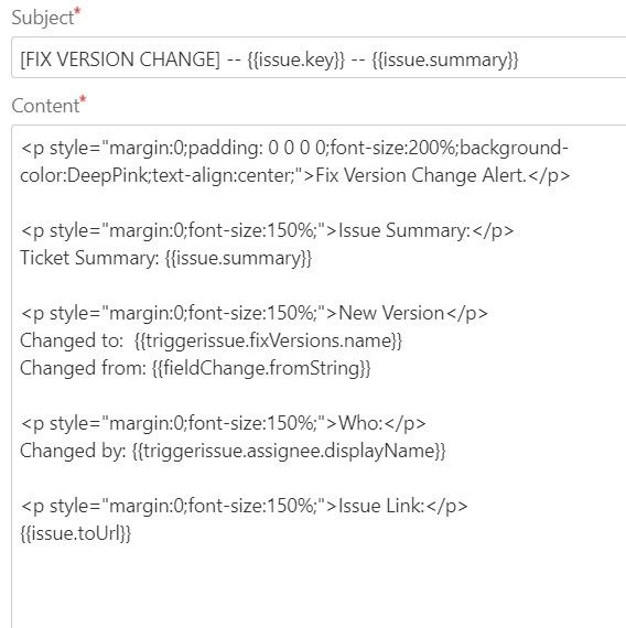

Have an automation that is triggered when a value is changed (FixVersions) and have an email sent that includes the new changed value, want to also add the previous value ... here is what I go so far .. but doesn't work:
Changed to: {{triggerissue.fixVersions.name}} <-- this works
Changed from: {{changelog.fixVersions.fromString}} <-- this does not work
Have tried a few different combinations of .name.fromstring and others without success.  Any help appreciated.

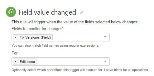

@[deleted] , I tried using your suggestion, for a rule triggered by change of Fix Version. It works well for everything, but {{fieldChange.fromString}}. It displays a blank for this. However, it works fine with {{fieldChange.toString}}
I tried the exact same solution where I have the trigger based on change if other fields like 'assignee'; where it works well for both fromString and toString. Any thoughts on why it does not work for FixVersion?
My trigger condition pasted below

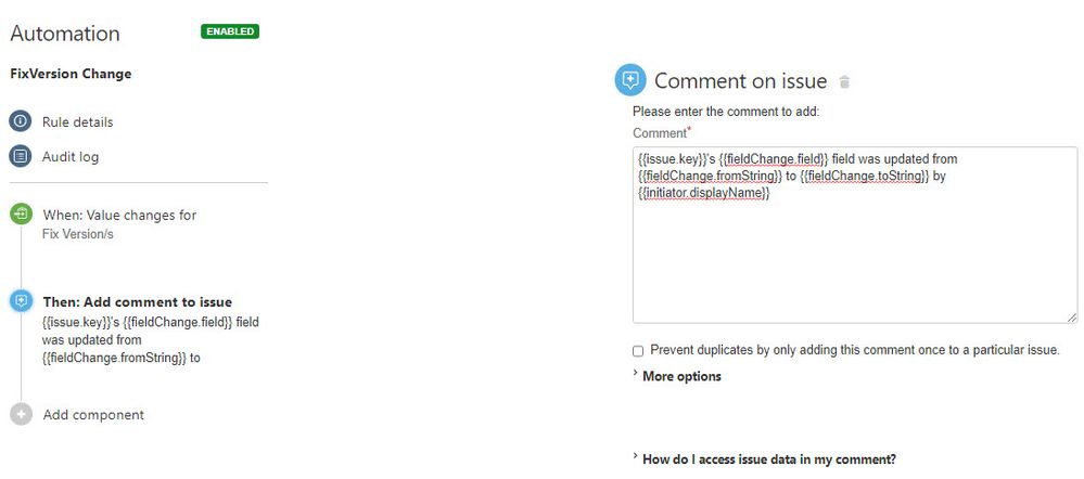

Here is my scenario and rule setup ; I had FixVersion as v1.1 on a JIRA Story PRO-100, and I edited the Fix Version/s to v1.2. The goal is to add a comment on the story when fix version changes. In my example, the rule got triggered and the output was as below
{{issue.key}}'s {{fieldChange.field}} field was updated from {{fieldChange.fromString}} to {{fieldChange.toString}} by {{initiator.displayName}}
resulted in adding below comment
PRO-100's Fix Version field was updated from to v1.2 by Raji Joseph
whereas, I was expecting it to be
PRO-100's Fix Version field was updated from v1.1 to v1.2 by Raji Joseph
as you see, the output of {{fieldChange.fromString}}, came out as blank
Snapshot of the complete rule pasted below
Mathew Sommers
July 9, 2020
Here is what I wrote for ours and it works and should get you some ideas.

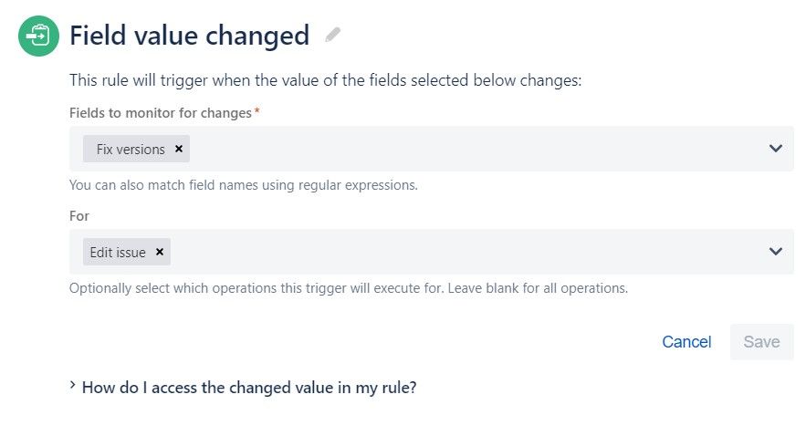

Raji
July 9, 2020
Mathew, thanks for your response. I tried replicating the smart values examples that you shared above, and still getting a blank for the 'fromString'
Could you share your trigger condition pls
Also, in your use case, how are you editing the fixversion? Manually, right?
Mathew Sommers
July 10, 2020
I manually change.  Clicking in the Fix Version field and selected the new Fix Version.
Here is the trigger.
Raji
July 10, 2020
Thanks, @Mathew Sommers
Looks to be similar to the trigger condition I posted above. But, does not work for me

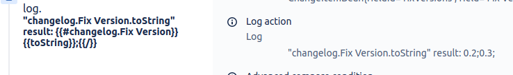

OlehK
August 24, 2022
Hi, @Mathew Sommers. I don't know if you found a solution, but I have found one.
We can see the following example in the docs {{#changelog.fixVersion}}{{toString}},
Screenshot from docs
but it isn't correct, because in the changelog the fixVersion field is called 'Fix Version'
Screenshot from Jira Automation log:Screenshot from 2022-08-25 01-13-56.png
So, if you want to get all fixVersion changes from #changelog please use
{{#changelog.Fix Version}}{{toString}} instead of {{#changelog.fixVersion}}{{toString}}
Result of execution:
In your case it should be {{changelog.Fix Version.fromString}} instead of {{changelog.fixVersions.fromString}}
I hope you'll find it useful.

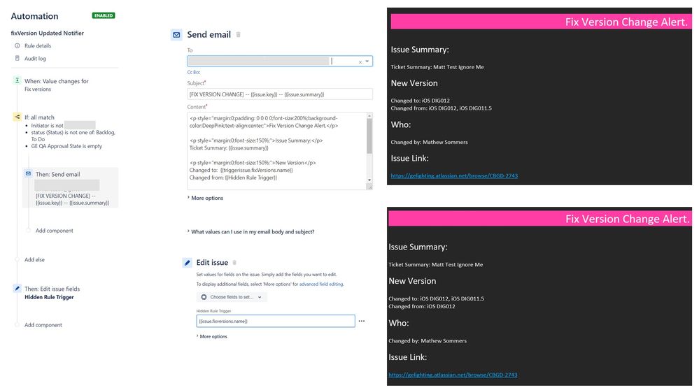

Mathew Sommers
September 30, 2020
I was able to solve this issue with a small work around.  They way I did it was to create a hidden field that when the FixVersion changes, I copy the changed value into it ... the next time it changes, I pull from that value as the 'old value' and then after reporting, update the value.  Screen shot shows the rule and the resultant email screen shots.

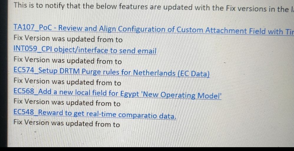

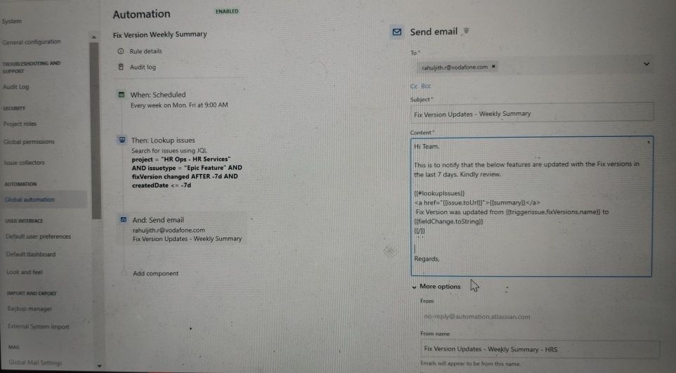

Rahul Jith
August 29, 2022
Rahul Jith
August 30, 2022
Hi @OlehK
Hope you doing good!
Can you show your complete code with the automation rule. I have tried with replacing fixVersions to Fix version and it still failed. Also tried with the details shared and it's still not working.
If you can share the complete code it will be helpful.
My requirement is any changes to fix version should be notified with old version details and new version details.
