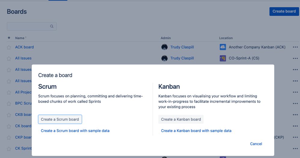

Go to the Boards list screen and select Create Board.
Click the Create a Kanban Board button.

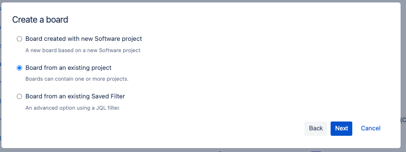

Select Board From an Existing Project and click Next.

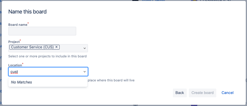

In the Project field select the Service Management project.
You'll have to specify a Name for the board and a Location. Because Service Management itself as a product doesn't support agile boards you can't select the Service Management project as the Location. You can select a Software project as the location (and the board will show in the list of Boards for that project) or you can set the location to Personal.

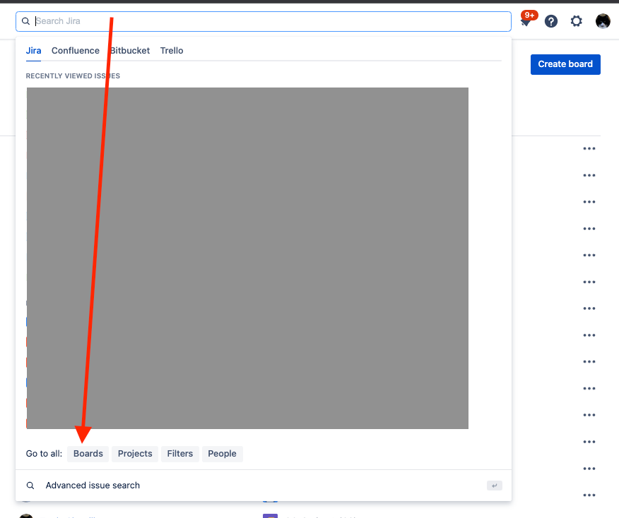

Click on the Search field near you avatar. You'll find a Boards button at the bottom of the pop-up. Click that button.

How do I bring up the Boards list screen, I dont see an option in Service management
