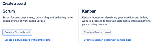

To create the board, navigate to any of your projects and select the project board. Expand the list of boards from the top left and select Create board. Choose a scrum or kanban board:

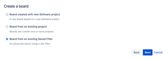

Then select to create a board from an existing saved filter:Screenshot 2020-12-03 at 17.55.42.png
In the next step select the saved filter you created before. And you should end up with a board having a single backlog across multiple projects.
