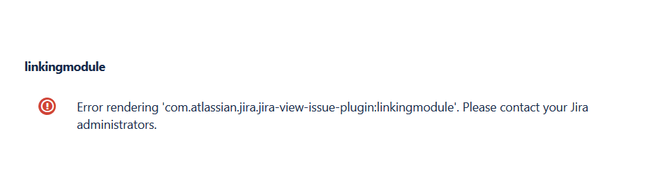

Yes I tried that, and it worked better with jira.permissions.link=denied. But that only worked for not being able to link the issue I was in, what I want is other issues not being able to link to it.
Plus, when I put that propertie I got this error, so that is why I am looking for alternatives image.png

Linking happens on both sides so if the permission is set on the closed issue then the other issues also should not be able to make links to that issue.
However you will still get the option to link it and the error message you will get is not intuitive but that is the best possible solution at the moment.

Hi @Prakhar Srivastav {Appfire} , I tried it and was still able to link, so it works different in cloud than in server.
I now the server add-ons, I am looking for alternatives for cloud,, as there are a lot of linking add-ons for cloud and maybe one of them offeres restrictions.
