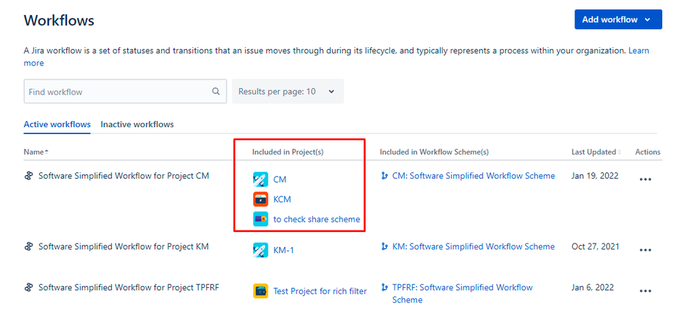

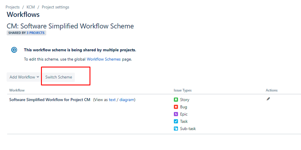

There is no Move Option, But we can use  same workflow if both projects are in same site.
In Project settings --> select workflows--> there u will find switch scheme. Then select the required workflow scheme. ( For this you need Jira admin access)
As you can see, I have used same workflow for 3 projects.
