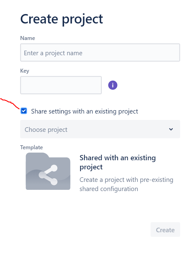

@bertrand berthomieu
Welcome to the community.  Each new project will have it's own scheme unless when you create it you check the share setting with an existing project.  You can always update a project after it is created to use an old scheme as well.
