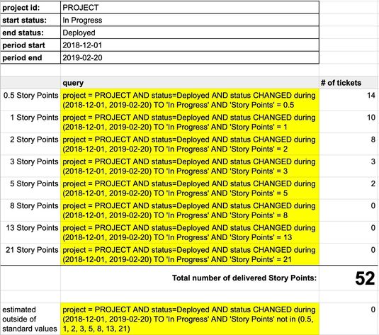

Valentyn Barmak
February 19, 2019
So, clearly, no easy solution for Kanban.
As a workaround, I apply filters. I search for tickets that were estimated "Story Points" = "1", then replace "1" with "2", an so on. Record the numbers and sum them up.
So the detailed steps are the following:
1. Decide on the period. The format is: (2019-01-01, 2019-02-01)
2. Decide which JIRA statuses mean start of work on the ticket / completion of work. For me, statuses are called "In Progress" / "Deployed".
3. Write a Search query in JIRA to get all tickets that were estimated as 1 story point
project = "PROJECT" AND status=Deployed AND status CHANGED during (2019-01-01, 2019-02-01) TO "In Progress" AND "Story Points" = "1"
4. Write down the number of tickets that you got with this search.
  • 10 tickets: with Story Points = 1
5. Repeat similar search for other values of Story Points: 2,3,5, whatever you use. Example:
project = "PROJECT" AND status=Deployed AND status CHANGED during (2019-01-01, 2019-02-01) TO "In Progress" AND "Story Points" = "2"
project = "PROJECT" AND status=Deployed AND status CHANGED during (2019-01-01, 2019-02-01) TO "In Progress" AND "Story Points" = "3"
project = "PROJECT" AND status=Deployed AND status CHANGED during (2019-01-01, 2019-02-01) TO "In Progress" AND "Story Points" = "5"
Record your results:
  • 14 tickets: with Story Points = 0.5
  • 8 tickets: with Story Points = 2
  • 3 tickets: with Story Points = 3
  • 2 ticket: with Story Points = 5
  • 0 ticket: with Story Points = 8
6. Now if you calculate the sum, you will have total number of story points accomplished within a period.
For the example above, total Number of Story Points = 14*0.5 + 10*1 + 8*2 + 3*3 + 2*5 = 52 (Story Points).
P.S. You may want to add some automation. I get the queries automatically assembled in Google Sheets:
You can make a copy of it and set it up to your liking.
