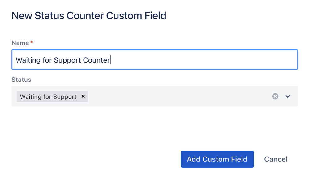

Hi @Phillip Talbot ,
You can use the Enhancer Plugin for Jira for this.
It has a custom field called Status Counter that does the exactly what you're asking for: Counts the number of times the issue is in that particular status.
This custom field can be used to sort or search in issue navigator.
Enhancer Plugin for Jira has many more custom field types that can fit your different requirements.
Please let me know if you have further questions.
Regards,
Gökçe
Please note that I'm one of the members of the Snapbytes team.
