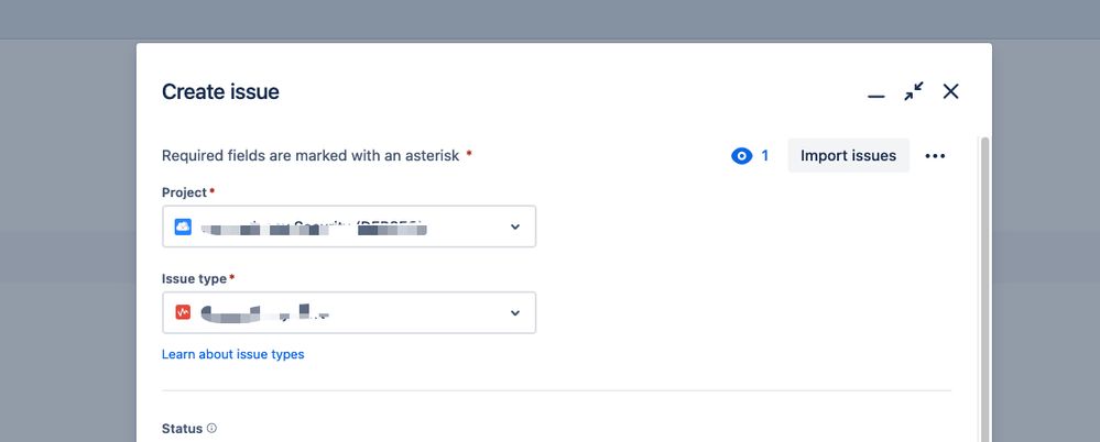

My question is, when you use the security integration with github in a project, there is a button to create a jira ticket from a vulnerability that opens a form like the one shown in the next screenshot.
My problem is that eventhough the security vulnerabilities integration is set in one project (the one with the cloud symbol), users can create vuln tickets in any project they desire. My org want to have all the security related tickets in this same project.
We can ask users to always use that project but I would love to make this mandatory (or even remove the project option from the ticket creation form) but I think is not possible.
Just wanted to double-check in case there is an option for that.
Regarding user schema: what I did, indeed, was to remove all but one issue type from the issue type scheme, so, if the user selects the right project, they will only be able to choose the right issue type. The problem appear if they change the project to a different one, then they won't have the right issue type available :/
Thanks for your response, let me know if you have any idea!
