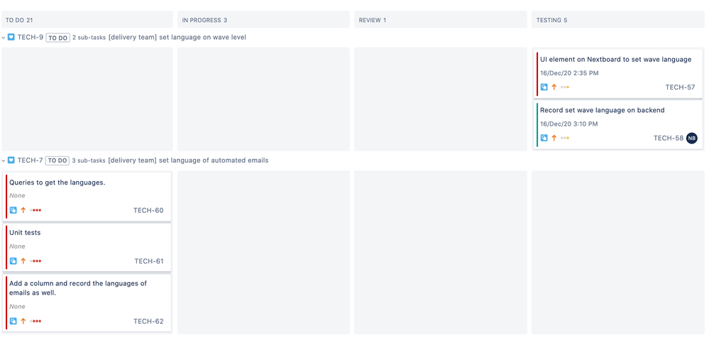

2) Adjust view to only see user stories (no subtasks)?
Is there an easy way to only see user stories and not show subtasks in the swimlane column? Currently I see it like this which is not easy to get an overview so I would love to only see the user stories itself.

Hi @lisa,
Ordering the tickets is indeed done using drag and drop. It updates the ranking of you tickets and keeps them in the order you decide they should be in.
I think your board currently has swimlanes by stories, which is why you have all the subtasks visible and grouped underneath their parent stories, You can change that in Board Settings > swimlanes. Change the setting to none (or optionally to something else that makes more sense to you).
To remove the subtasks from the board view, you could modify the board filter. In the same Board Settings > General you'll see the filter with a link underneath Edit Filter Query. Click that link to edit the filter and update it somewhat like this:
Project = TECH and issuetype in StandardIssueTypes() ORDER BY Rank ASC
The main addition being the issuetype in StandardIssueTypes(). That part will eliminate the subtasks from your board, but you'll still be able to see them on the story card details.

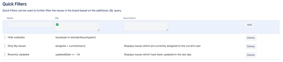

About the subtasks: yes. It may even be a better idea to add quick filters to your board. In that case, forget about modifying your board filter, but instead go to Board Settings > Quick filters and add a new quick filter like this:

Thank you for the quick filters (also the others are very useful!)
However regarding the quick filter for "hide subtasks" the problem is that it just doesn't show the subtasks. What I was hoping for is that those tickets will then all appear in the same format of cards (if subtasks are assigned or not). Currently tickets with subtasks are still shown as a line of text vs. tickets without subtasks are shown as cards.
