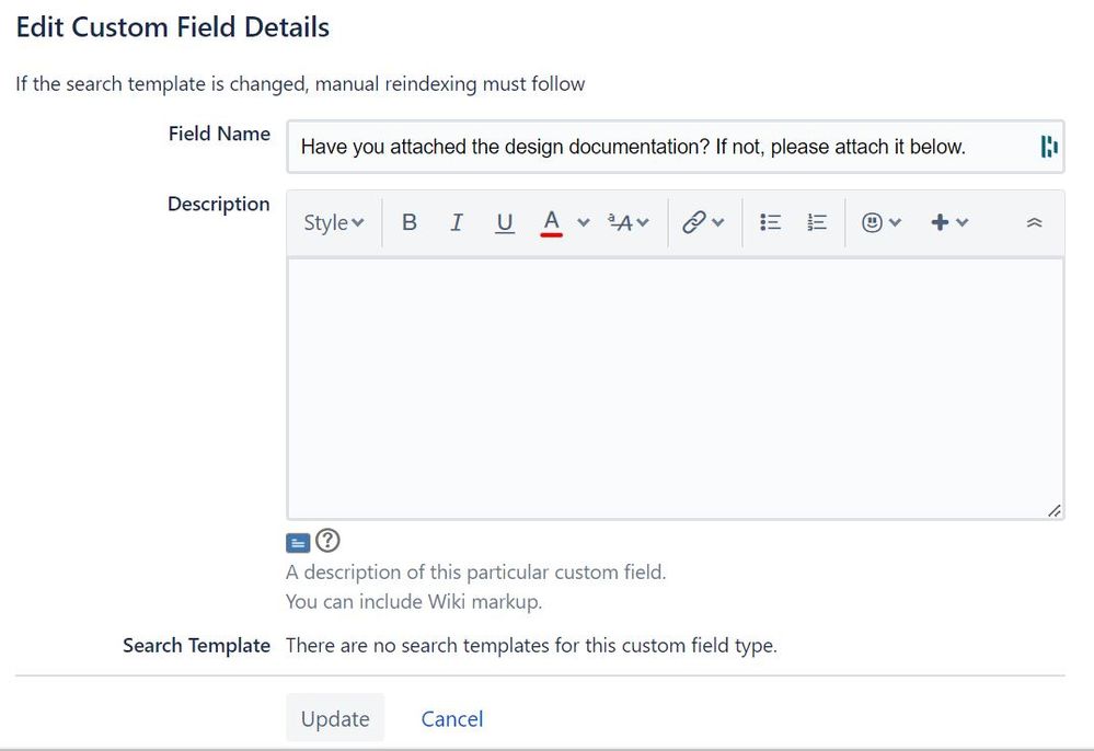

When setting up the field, there's no option to enter a default value:
What am I doing wrong?

Scrap that! Found it! And it's all working perfectly!

Ah, beat me to it!   Glad you found it faster than I could respond!
For anyone else landing here, the default value for fields is set in the "context" for the field, not the "edit" shown above.
