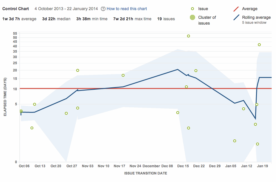

Jira’s built-in reports typically don’t allow for complex calculations like cycle time across multiple projects.
You can use the Control Chart, it shows cycle time for issues but is typically limited to a single project.
For more advanced reporting, you may want to explore additional add-ons available on the Atlassian Marketplace.

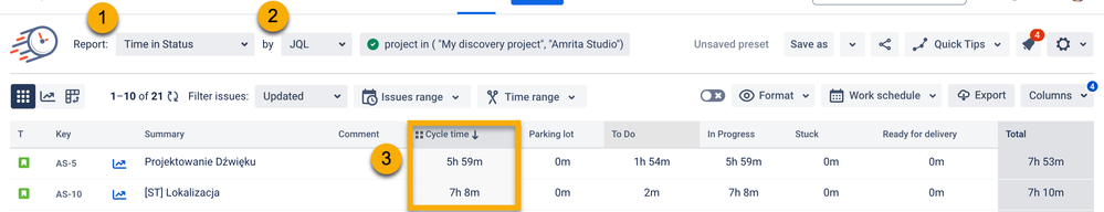

If you open to third-party add-ons to help, you can try Time in Status developed by my team. One of main purpose of the add-on is creating a cycle time report with data from multiple projects. To do this just:
  1. Choose Time in Status report
  2. Sort by JQL project in ( "project1", "project2")
  3. Get your Cycle Time Report with data from multiple projects
You can also book a live demo or contact us at Support - we'll show you the application inside out and answer all your questions.

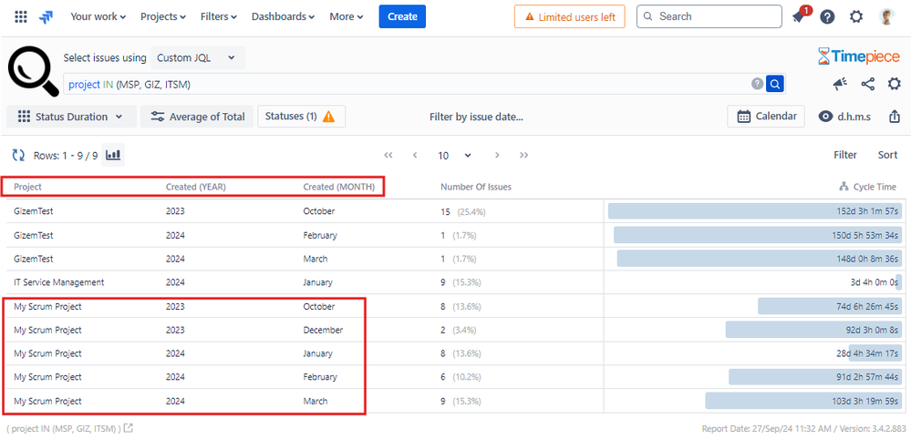

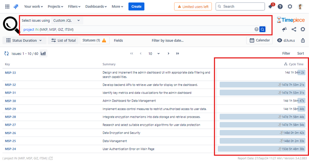

For that I can suggest you a marketplace app which will give you ready-to-go reports.  Timepiece - Time in Status for Jira ,the oldest and the most comprehensive "Time in Status" app in Atlassian Marketplace, which is developed by my team at OBSS, has a report type that will meet your need.  Our app is available for both Jira Cloud, and Data Center.
Timepiece mainly allows you to see how much time each issue spent on each status.
Status Duration report (please see the screenshot above) which shows how much time each issue spent on each status. You can combine the time for multiple statuses to get metrics like Cycle Time, Issue Age, Lead Time, Resolution Time etc. While forming the report you use JQL queries so this means you can create a single report which combines multiple projects.
For all numeric report types, you can calculate averages and sums of those durations grouped by the issue fields you select. For example total cycle time per project and created month
The app calculates its reports using already existing Jira issue histories so when you install the app, you don't need to add anything to your issue workflows and you can get reports on your past issues as well.
Timepiece reports can be accessed through its own reporting page, dashboard gadgets, and issue view screen tabs
If you wish, you can also schedule a live demo. We will provide a comprehensive overview of the application and address any inquiries you may have.
Hope it helps,
Gizem

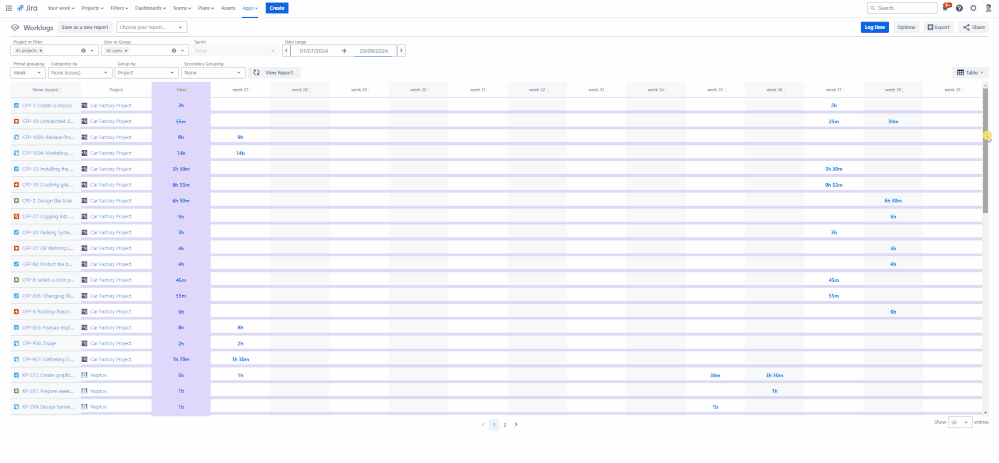

On behalf of the SolDevelo development team I would like to suggest to you our application called "Worklogs - Time Tracking and Time Reports" which per your requirements allows you to generate reports on the basis of multiple projects, tickets, users etc.
Additionally, you can group the reports by days, weeks, months or years and filter them by e.g. issues, subtasks, individual users and projects or groups.
If there is a need for presenting the data in a more visually appealing chart form, you can also view our reports as a customizable Bar and Pie chart:
Worklogs is easy to use and versatile, allowing to create flexible time reports and filter them in a granular manner, making it a great choice both for Jira newcomers and long-time users.
It's also worth noting that the app uses Jira's native time tracing and time logs, meaning that any time tracked previously with this method before its installation will be present in Worklogs.
If you haven't tested our app yet, I invite you to do so - it looks like it should meet your requirements. You can also book a demo with one of our experts and we will showcase the app and answer any questions you might have.
All the best!
Tomasz
