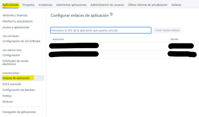

If you just want to PUSH your task to another jira instance you could simply connect your instances (cog icon next to your user avatar in the top right corner and select "Applications" from the drop down menu and then "Application links" in the left side menu. Names might be slightly different because I'm using the spanish UI and I'm translating it on the spot). Doing this you could clone your issue in the remote system but after doing that you won't see the evolution of the issue in that other system.

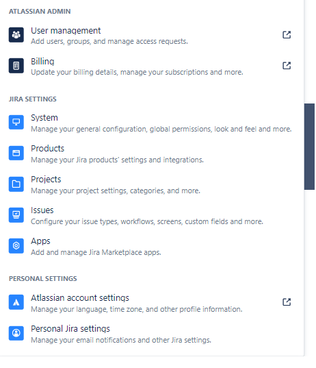

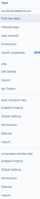

Hey @Iago Docando . From your instructions, I couldn't find 'Applications' on the dropdown menu - only Apps. Is this what you mean? If it is, there is no 'Application Links' under the available options on the side panel. I'm attaching these for your reference.Jira_Admin.png

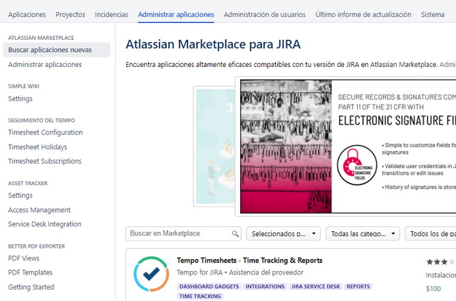

Oh, I see the problem. My indications where meant for Jira server, not cloud. The UI is likely different.
I believe you might be looking here:
imagen-2021-07-27-085940
But you need to be here instead (or the cloud equivalent):
imagen-2021-07-27-090226
