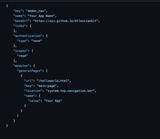

Above is the screenshot of the Atlassian connect.json file

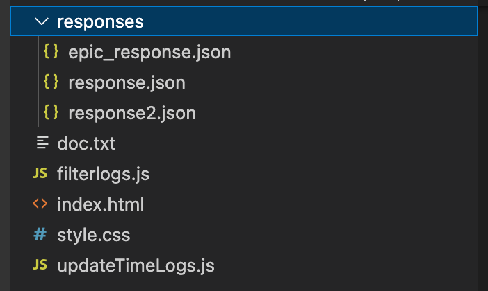

Below is my file structure

Your understanding of the baseUrl is correct. It must remain publicly accessible because Atlassian Connect uses this endpoint to load your app's resources (connect-json, index.html, etc.). This is mandatory. baseUrl and any endpoint defined under it must be accessible over the internet.
You can host only what is necessary (e.g. frontend code) on a server. Use secure backend API. But you cannot use a fully private repository because Jira cannot access resources behind oAuth or other access controls.
Use a publicly hosted, read-only version of static files like index.html, style.css and store sensitive logic in a private backend API which can be accessible via authentication.
You can also restrict access to your backend files to Jira (whitelisting Atlassian's outgoing IP ranges, refer to Atlassian's IP addresses and domains documentation)
