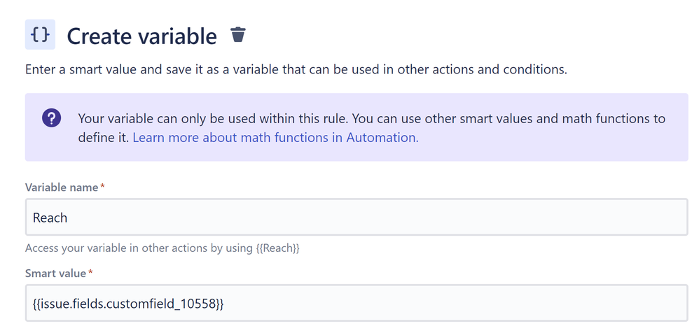

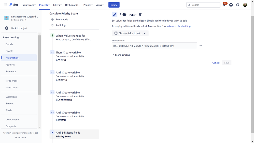

This is for people who find this in the future. I was able to set up a Jira Automation to calculate a value.
Trigger: Montior field values for changes.
Then I created Variables using Smart Values for each of the custom fields I created.
Once I had all of the variables defined, the final automation component was an Edit Issue field. I had set up a custom view only field so that it couldn't be edited directly by users. I used Andreas formula in the accepted comment which worked perfect for me.
{{#=}}({{Reach}} * {{Impact}} * {{Confidence}}) / {{Effort}}{{/}}

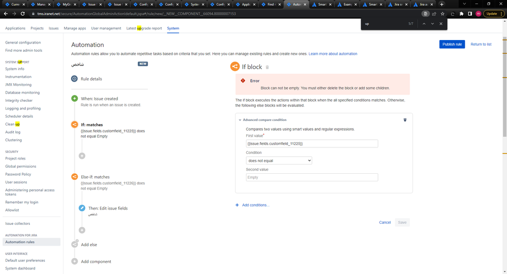

hi , can i use automation and make formula with custom field? if i can..could you please help me?
Yes itās possible. See my previous reply in this thread for more info.
thank you for explain..but i have problem could you please help me?

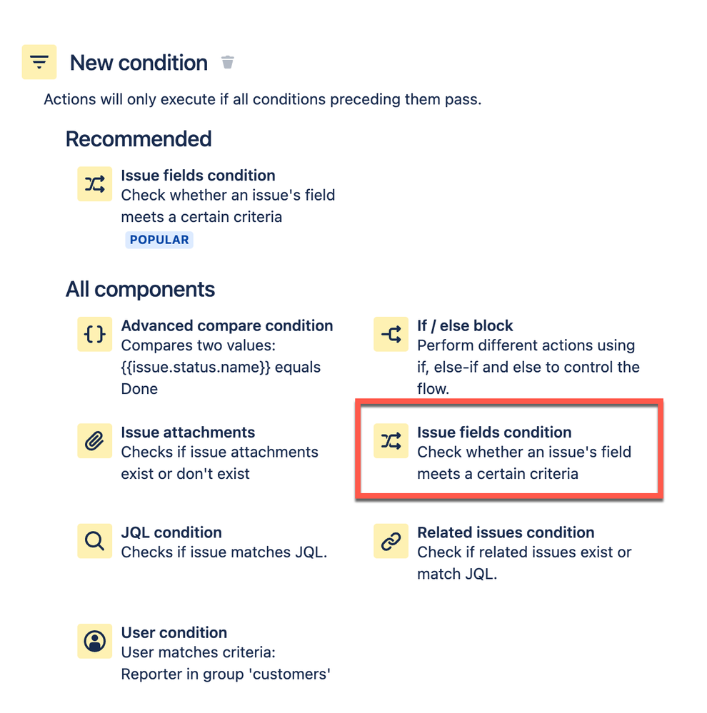

I think it's because you're using an If/Else statement, but it doesn't contain an action when the first If matches.
You're basically saying:
IF custom_field_11225 is not empty
THEN do nothing <-- This is what is causing the issue
IF custom_field_11226 is not empty
THEN edit issue fields
If the first IF statement does not have an action and all you're doing is checking if that field isn't empty before the next IF statement, consider using an Issue fields condition instead.
