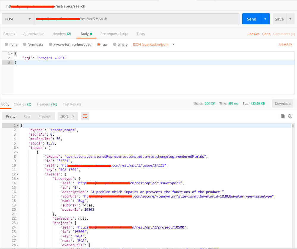

Here is the successful response from Postman:

But what you send with Postman as payload ist not the same you send with your Angular app. What are the two headers like displayed on your screenshot?

The problem and response is the same. I just copied the wrong one.

@Thomas Deiler, I was able to find a solution. It actually had nothing to do with angular, server configs, etc.
I believe the Jira API documentation is very misleading (or plain wrong). Everything I read about the Authentication API mentioned 2 ways of maintaining a session: Through request headers or through an Oauth token.
Because using headers was the simplest implementation, I went with that, but it turns out that the Jira API does NOT use the JSESSIONID header what so ever. It uses cookies.
The reason it worked with Postman, is that Postman saves cookies returned/set by the API much like a browser would. And so it would submit the cookies along with the calls.
That said, my ExpressJS API would only send headers as the Jira documentation  suggested. After fiddling around with many other ideas, I figured out that all I needed to do it send the JSESSIONID cookie along every call and it worked fine.
