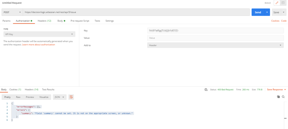

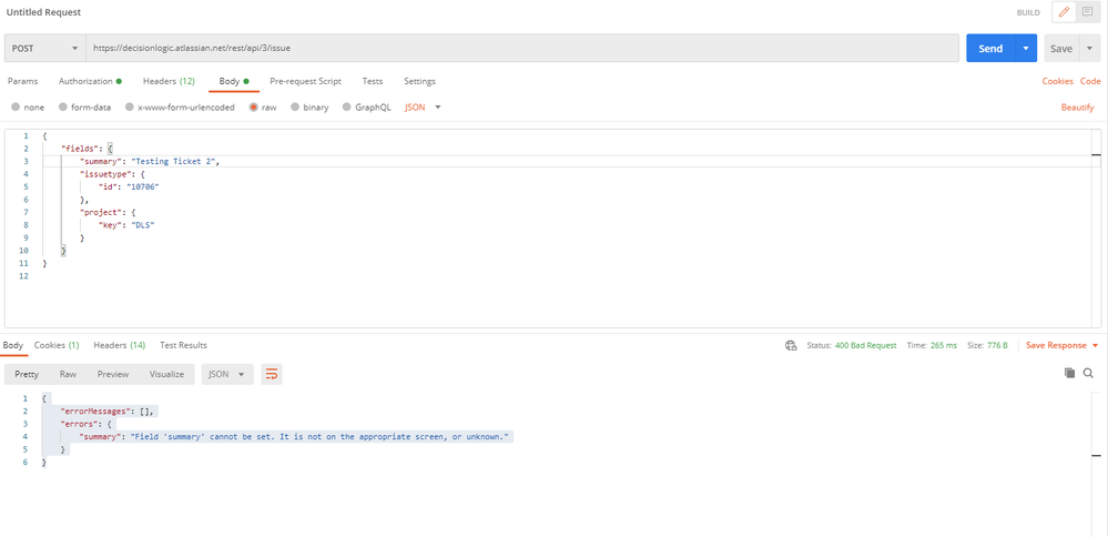

@Drew Nedderman, would it be possible for you to share some screenshots of how you are running the API call on the Postman? You can grey out the credentials.

Drew Nedderman
January 6, 2021
@mogavenasanhere are screenshots:
Postman Body.pngThank you!
mogavenasan
January 6, 2021
Hi @Drew Nedderman,
I can think of 2 items here:
  • Make sure you have created the API token from your account, not the API key on the Admin console; API tokens.
  • For the Postman, here is an example of how to include the credentials; this thread.
I hope that this will solve the issue here.
