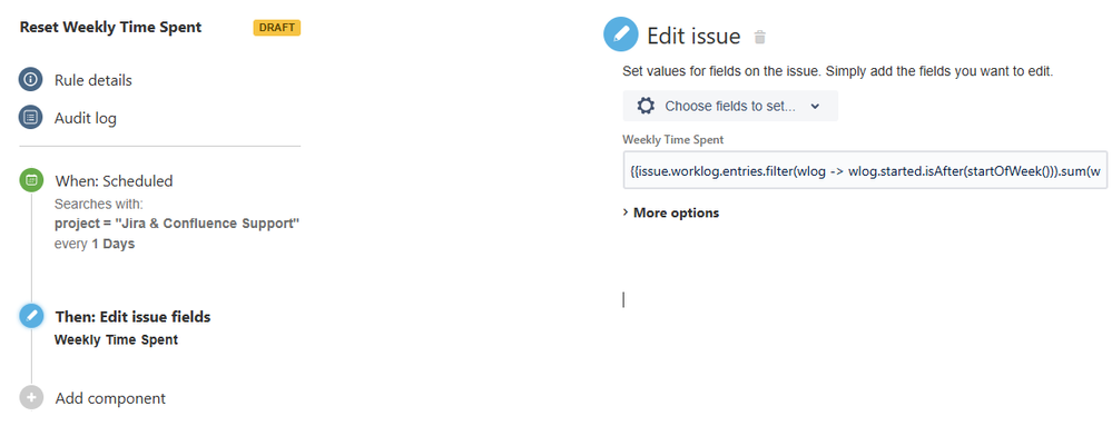

1. On Friday, I want to calculate the time spent by a user on a certain task during the week and place this total in a field called "Weekly Time Spent".
2. Every Friday at midnight, this field is reset and on Monday the count starts again.
I'm using Automation rule to solve this challenge, but I can't get the result. Custom field is not updated.
I'm using two triggers:
1st. When: Scheduled:
 a) project = "Jira & Confluence Support"
 every 1 Days
 b) The "Weekly Time Spent" field is edited and the following calculation is made: {{issue.worklog.entries.filter(wlog -> wlog.started.isAfter(startOfWeek())).sum(wlog -> wlog.timeSpentSeconds).divide(60)}}

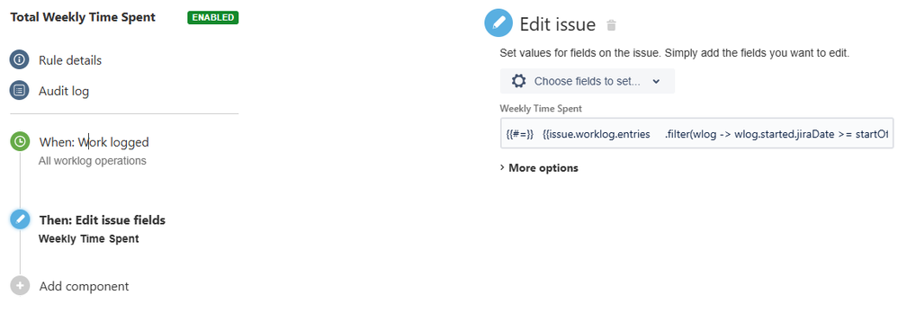

2nd. When: Work logged:
 {{#=}} {{issue.worklog.entries .filter(wlog -> wlog.started.jiraDate >= startOfWeek().jiraDate) .sum(wlog -> wlog.timeSpentSeconds) }} / 60 {{/}}
Does anyone have any idea how I can solve this challenge?
Thanks,
Emanuel
Error message:
Error rendering smart-values when executing this rule:
Failed to get value for issue.worklog.entries .filter(wlog -> wlog.started.jiraDate >= startOfWeek().jiraDate) .sum(wlog -> wlog.timeSpentSeconds): {{#=}} {{issue.worklog.entries .filter(wlog -> wlog.started.jiraDate >= startOfWeek().jiraDate) .sum(wlog -> wlog.timeSpentSeconds) }} / 60 {{/}}

Hi @Fidelidade JIRA Admin
There is no "filter" function for smart value lists.  Here are the supported smart values and functions: https://confluence.atlassian.com/automation/jira-smart-values-lists-993924868.html
Instead you could use an iterator and smart value, list filtering: https://community.atlassian.com/t5/Automation-articles/Filtering-smart-value-lists/ba-p/1827588
I recommend experimenting with just one issue, writing the results to the audit log, until you get the iteration and filtering to work as needed.
