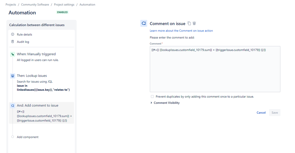

Is possible calculate the field values between issues. First of all, I'm assuming that the new issues created are associated with the first Issue A with the same linkissue type. On my example, I will use 'Relates to' link type. But feel free to adjust for your case.
Define your trigger
Define your Condition
Add a lookupIssues Action:
- Add the JQL: issue in linkedIssues({{issue.key}},"relates to")
Change 'Relates to' for the link type you're associating your Issue Types
Add your Action for Edit Issue > Select your field:
- In your field, insert this smart value:
{{#=}} {{lookupIssues.customfield_XXXXX.sum}} + {{triggerIssue.customfield_XXXXX}} {{/}}
Replace XXXX for the field ID.
Here is the example of the rule:
