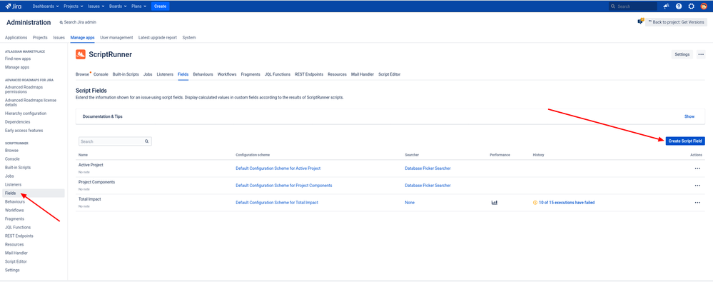

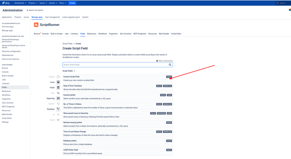

To setup, the scripted field, go to the Fields option and select the Create Scripted Field option as shown below:-

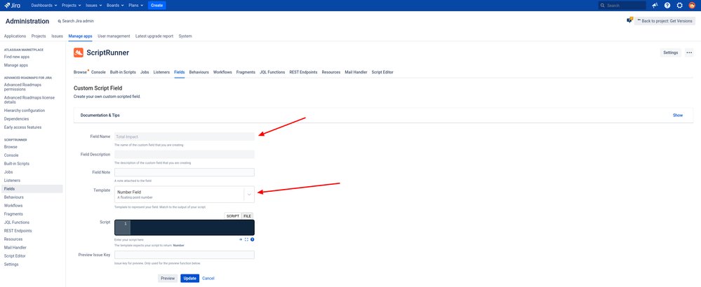

Next, select the Custom Script Field option as shown below:-
Next, provide the Field Name you want to use and select the Number Field type as shown below:-

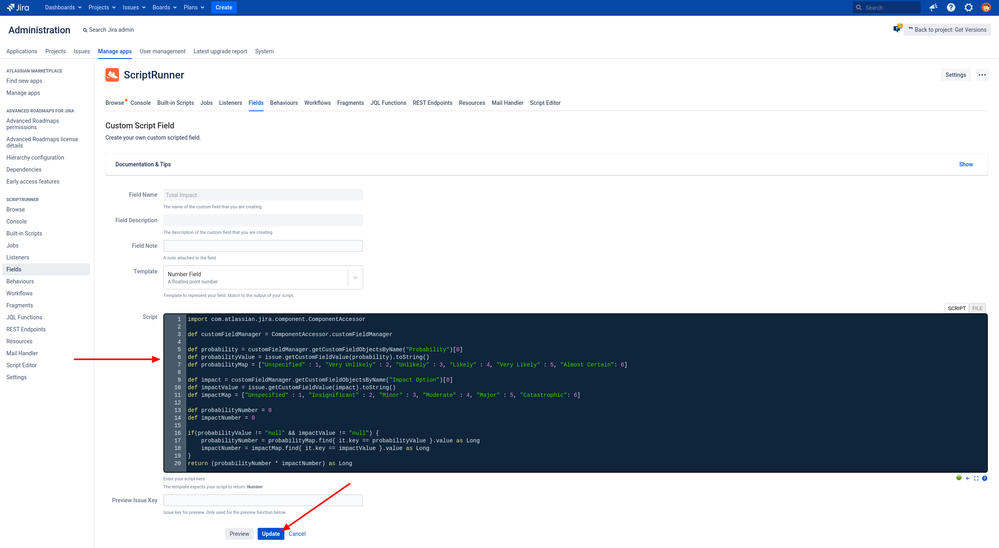

Next, add the code to the script field and Update it as shown below:-

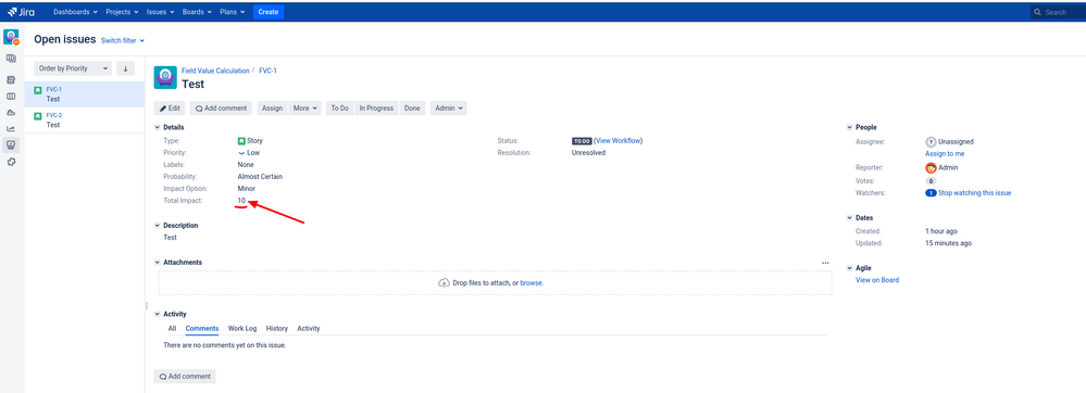

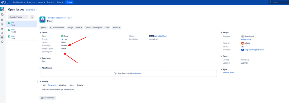

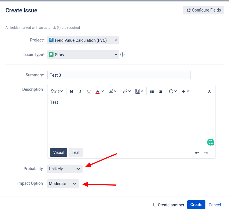

1) First, create an issue and select the values for the Probability and Impact lists and create the ticket as shown below:-
2) The Scripted Field is only visible on the View Screen and not on the Create or Edit Screen. Once the issue has been created, the Scripted Field will display the output as shown below:-

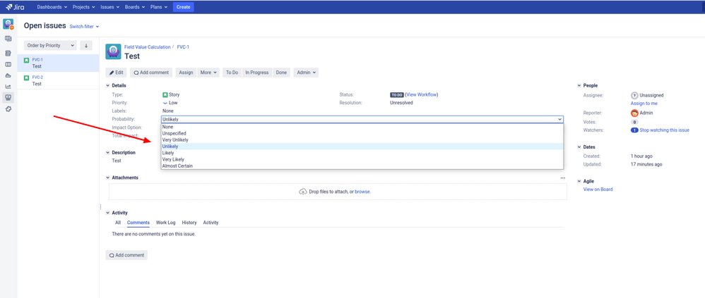

3) Try updating the Probability or Impact options, and you will see the Scripted Field will update as well as shown below:-

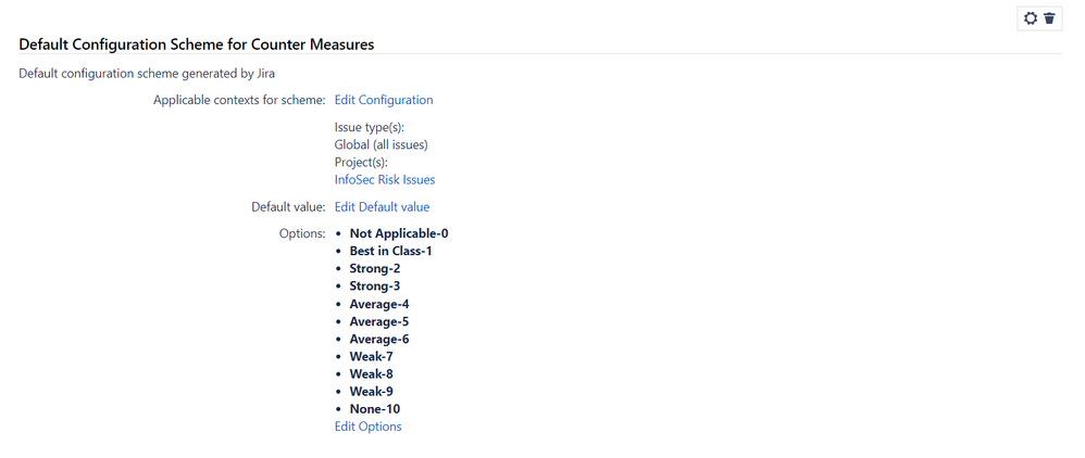

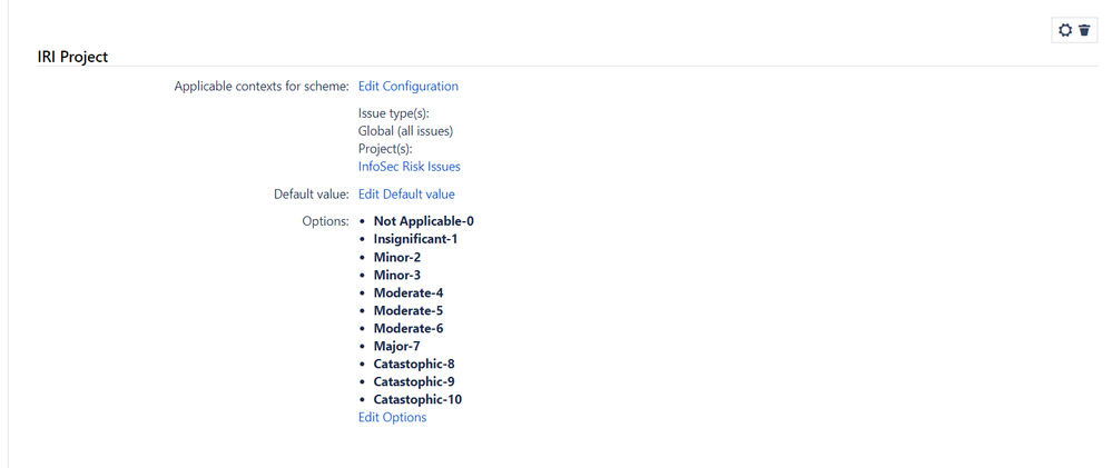

Akshith Kumar
March 24, 2022

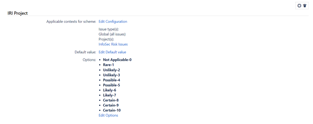

Counter Measures field.PNGImpact field.PNGLikelihood field.PNGTest Issue.PNG
Akshith Kumar
March 24, 2022
@Ram Kumar Aravindakshan _Adaptavist_
I have used the below script in RPN Script field let me know if I need to do any changes in the script
import com.atlassian.jira.component.ComponentAccessor
def customFieldManager = ComponentAccessor.customFieldManager
def Impact = customFieldManager.getCustomFieldObjectsByName("Impact")[0]
def ImpactValue = issue.getCustomFieldValue(Impact).toString()
def ImpactMap = ["Not Applicable-0" : 0, "Insignificant-1" : 1, "Minor-2" : 2, "Minor-3" : 3,"Moderate-4" : 4, "Moderate-5" : 5, "Moderate-6": 6, "Major-7": 7, "Catastophic-8": 8, "Catastophic-9": 9, "Catastophic-10": 10]
def Likelihood = customFieldManager.getCustomFieldObjectsByName("Likelihood")[0]
def LikelihoodValue = issue.getCustomFieldValue(Likelihood).toString()
def LikelihoodMap = ["Not Applicable-0" : 0, "Rare-1" : 1, "Unlikely-2" : 2, "Unlikely-3" : 3, "Possible-4" : 4, "Possible-5" : 5, "Likely-6": 6, "Likely-7" : 7, "Certain-8" : 8, "Certain-9" : 9, "Certain-10" : 10]
def CounterMeasures = customFieldManager.getCustomFieldObjectsByName("Counter Measures")[0]
def CounterMeasuresValue = issue.getCustomFieldValue(CounterMeasures).toString()
def CounterMeasuresMap = ["Not Applicable-0" : 0, "Best in Class-1" : 1, "Strong-2" : 2, "Strong-3" : 3, "Average-4" : 4, "Average-5" : 5, "Average-6": 6, "Weak-7" : 7, "Weak-8" : 8, "Weak-9" : 9, "None-10" : 10]
def ImpactNumber = 0
def LikelihoodNumber = 0
def CounterMeasuresNumber = 0
if(ImpactValue != "null" && LikelihoodValue != "null" && CounterMeasuresValue != "null") {
ImpactNumber = ImpactMap.find{ it.key == ImpactValue }.value as Long
LikelihoodNumber = LikelihoodMap.find{ it.key == LikelihoodValue }.value as Long
CounterMeasuresNumber = CounterMeasuresMap.find{ it.key == CounterMeasuresValue }.value as Long
return (ImpactNumber * LikelihoodNumber * CounterMeasuresNumber ) as Long
