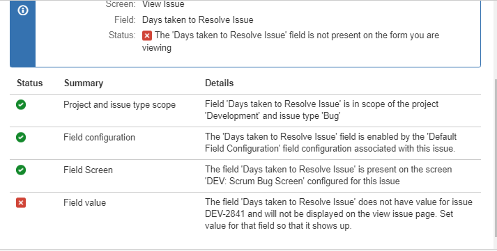

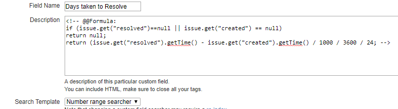

Hi @Constance Hua, I tried everything but this is what the error i'm receiving, can you please help what is pending with this?
Also, looks like when i'm using the formula the getTime() part is getting marked in red is that something is missing?
hi @Prashant Samal,
those fields are not existing as fields. They are just some kind of metadata it seems.
You need to create manually those fields or find their id
