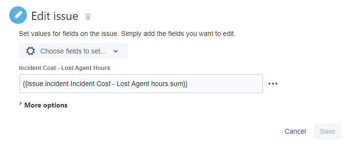

The only thing I changed was in the edit field section to match the field I needed to look up:
Any ideas where I'm going wrong?

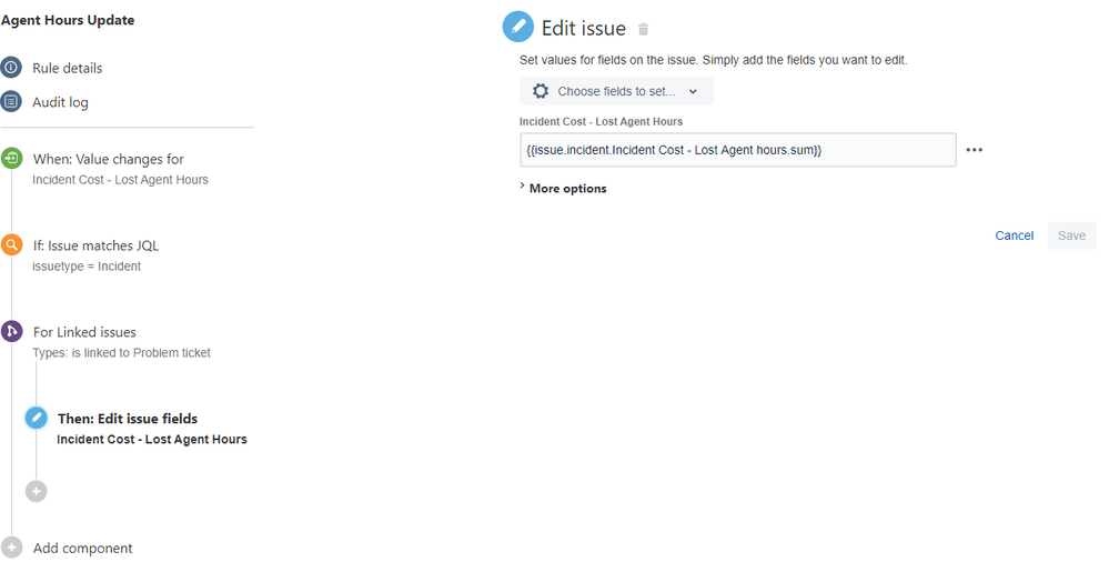

Thought I should also include a screen grab of the whole rule in case I've really messed it up! :)
Why do you have issue.inicident.Incident Cost and not just {{issue.Incident Cost? I think you have an extra incident word in there.

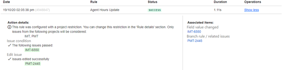

Hi @John Funk thanks. No idea how that got in there! I've removed but the rule still doesn't pull the agent hours from the incident to the problem. The audit log doesn't show any errors which makes me think the rule is working but just not doing what I want it to do?
Any ideas?

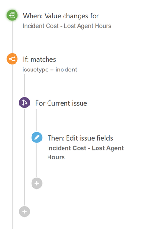

Hi thanks for the reply,
My rule is as follows:
Breakdown of steps:

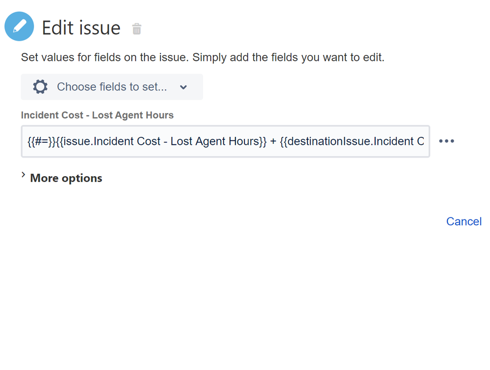

As you can see I've tried looking at things like destinationissue.xxx and that is giving me the same result as issue.xxx
The tickets in Jira are linked by the link type 'is Problem Ticket for' / 'is linked to Problem ticket'

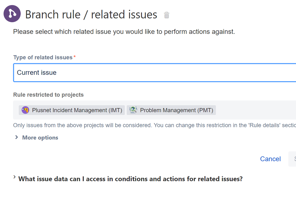

For the branch, try using For Linked Issues instead of Current Issue.
Then use {{triggerIssue.Incident Cost - Lost Agent Hours}}+{{issue.Incident Cost - Lost Agent Hours}}
