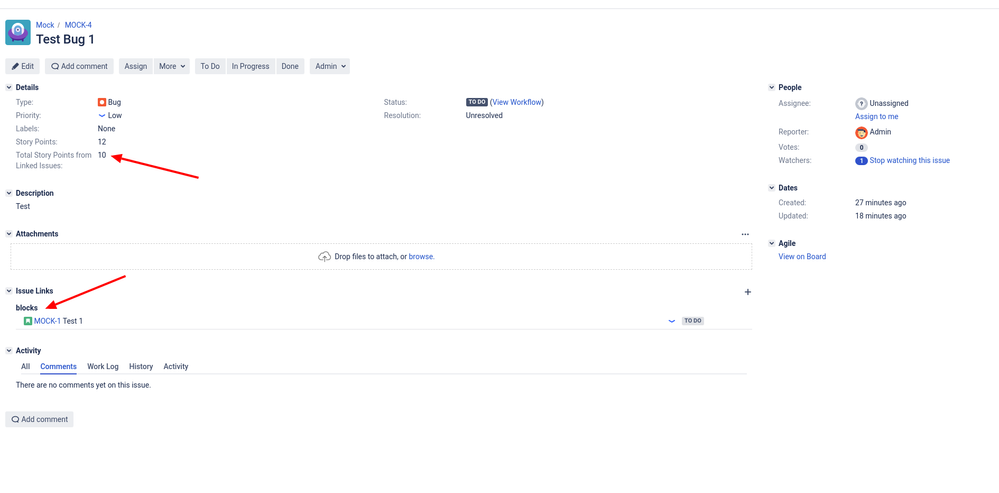

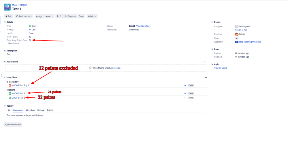

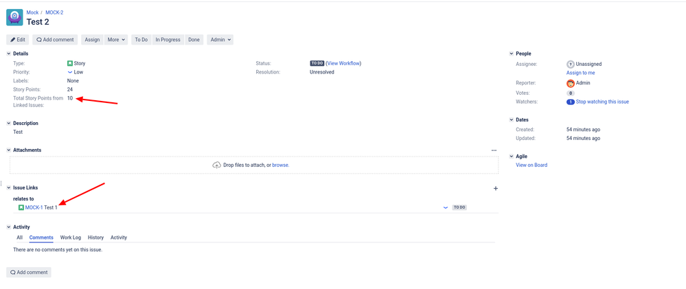

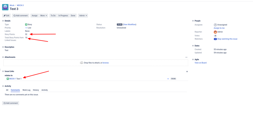

Below is a screenshot of the Scripted Field's configuration:-
I also include a couple of test screenshots for your reference:-
The first issue is linked to 3 other issues. Two are using the relates to link, and one is using the is blocked by link. If you compare the first screenshot below with the other three screenshots, you will notice that in the issue MOCK-1, only the story points from MOCK-2 and MOCK-3 are calculated. However, the story points from MOCK-4 are excluded because it is a blocker.
I hope this helps to solve your question. :-)
