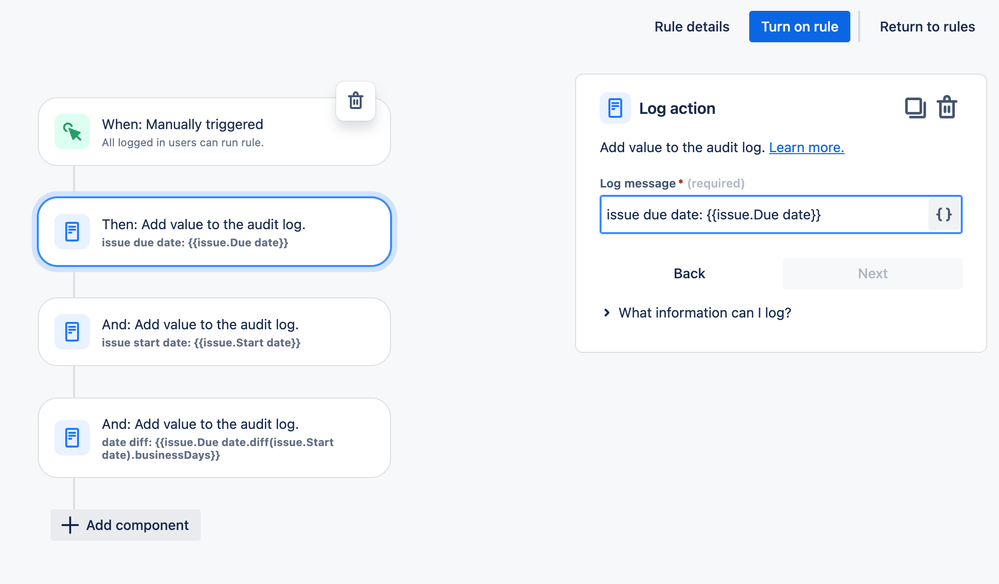

A debugging technique that is available to you is to use the Log action to print into the rule Audit Log the values of the smart values you are trying to use. That will help you determine if the right information is being obtained from the issue.
If you can do that and run the rule again, and provide the requested screen images, and an image of the issue against which the rule ran showing the Due date and Start date fields, we will be better able to help you diagnose the problem.

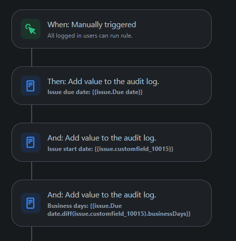

Trudy P Claspill
July 5, 2024

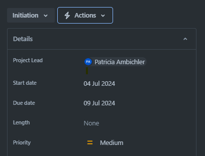

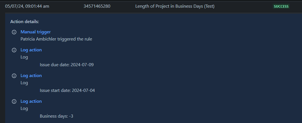

But what do you get when you add the Log actions to your own rule?
patricia.ambichler
July 5, 2024
The "right" answer, just with a negative - (still with a manual trigger)
Trudy P Claspill
July 5, 2024
It would be helpful if you put those Log actions into your actual rule and execute the action that triggers your rule to run. Then show us both your complete automation rule and the output in the Audit Log from the rule execution.
If you aren't getting the expected result in your actual rule, we need to see that information to debug the reason.

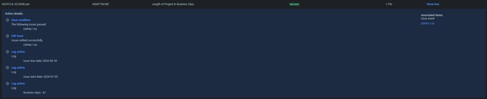

patricia.ambichler
July 7, 2024

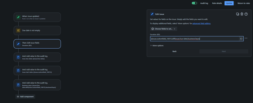

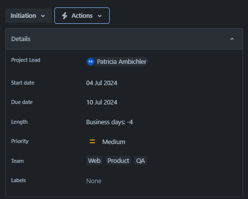

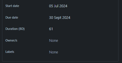

To achieve no (-) in the Length field, I swapped the start and due dates in the smart value
The log, completed rule,and ticket below. It's interesting because the log now shows (-) but the ticket field is correct. Not sure what exactly is happening with the result, but happy with it.
Thank you so much for your help @Trudy P Claspill !
Screenshot 2024-07-08 083622.pngScreenshot 2024-07-08 083649.pngScreenshot 2024-07-08 083711.png
