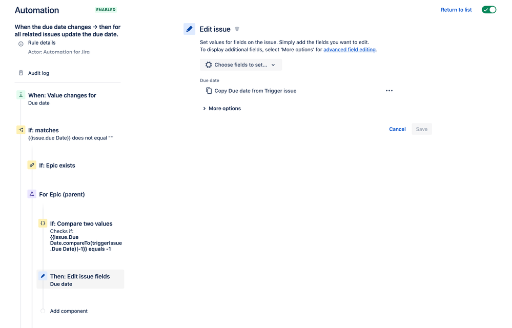

If you don't, you could set up an automation rule like this one from the template library:
Screenshot 2022-07-02 at 20.13.23.pngFor your existing Epics, you would have to take a look at the latest due date of all child issues and set the current due date correctly. But once that's done, this approach might work for you.
Every time the due date of an issue changes, the rule will check if the issue has an Epic linked to it. If it does, it will compare the issue's due date with the one on the Epic.

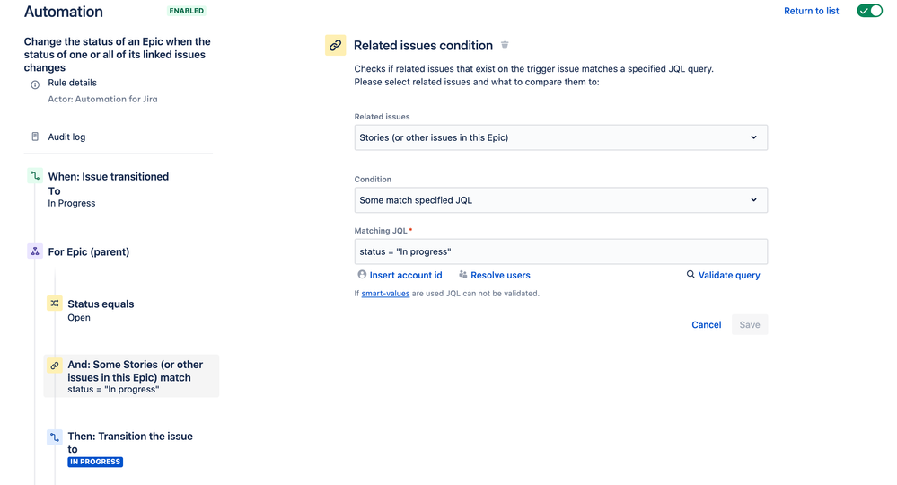

You should make sure to set the proper conditions, of course. That may even include validating the due dates of all other child issues of the epic, like in this example:
Hope this helps!
Javanshir Mustafayev _ HIT
July 6, 2022
Hello @Walter Buggenhout thanks for your broad reply, but will this calculate all the due dates and display how many days in total will one particular epic take to get completed. I wish to display this on the project Board where the Epic cards are for each Epic?

Hi @Javanshir Mustafayev _ HIT,
This will calculate the due date of an Epic, based on the due date(s) of its child issues. You can display the due date field on the issue cards on your board, so you can see the due date of each epic on the board.
It does not calculate the number of days it will take, just the due date.
