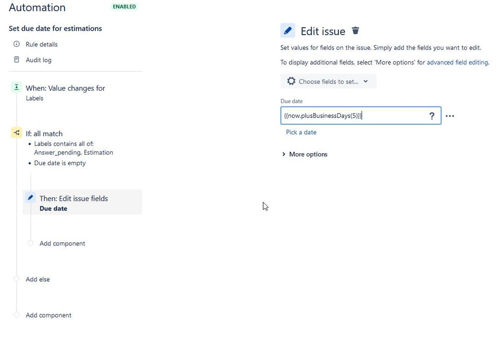

Currently, we have an automation rule set up for all projects, which sets automatically a due date for all estimations we need to provide.
In this case, for example, an estimation needs to be provided within 5 working days. However, the due date needs to be calculated based on the client’s calendar. Their holidays are different to ours so if e.g an estimation is requested on 22/12, the rule will set the due date to 29/12. This is incorrect, though, because during 23/12-2/1 the client will be on holidays. Therefore, the correct due date would be 7/1.
What we currently do is check if there is a holiday and manually adjust the due date if needed, but we would like to have a way to do this without going through the manual calculation.
Is there a way to do it? Maybe a calendar add-on which we can populate with client's holiday dates. Then use that calendar to the automation mentioned above? Any other suggestions?
