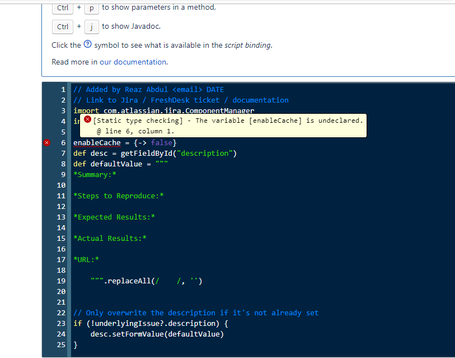

Auto-populated some content in Description for a 'Bug' issue type in Particular Project, when we change the issue type from Bug to other, the description remains the same.
FYI: From other issue types to Bug, auto-populate is working as expected.
And also i have tried with
enableCache = {-> false}
Getting an error, please check attched screenshot.

The enableCache = {-> false} is only applicable for scripted field as far as I can tell from the documentation.
