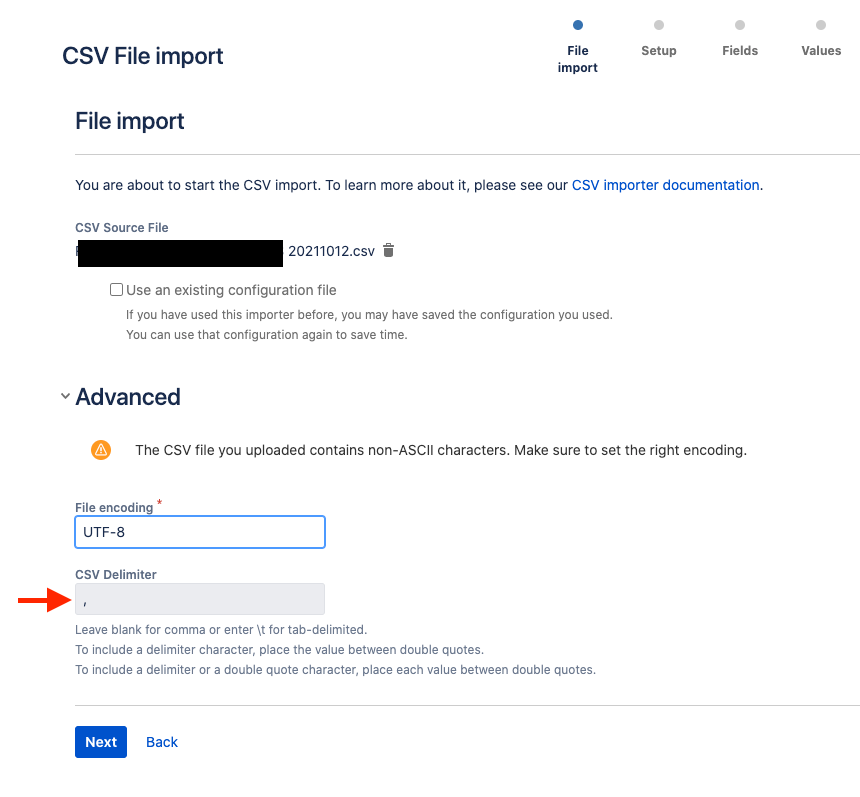

Hi, i am trying to load new Stories to a Project, but the vertical seperator is not recognized. All 10 columns are realized only in one, instead of getting pulled into 10 seperate fields.
In the screen "Map Fields" all line content from the CSV is shown in the first csv column target only - all other 9 remain empty, and so the load fails due to missing type, summary,...
How to overcome this problem? I tried using different separators, I created one manual Story in Jira, downloaded CSv with "|", used it as blueprint for the file but still no chance.

Regardless of which you are using, in Jira Cloud at least there is a point in the process where you have the option to set the CSV file delimiter. Are you changing that from a comma to the | character?
@Trudy P Claspill : the seperator was changed - also in the various try outs with comma semicolon, and finally the vertical bar.

I am not using the admin loading function, but through the navigation bar
-->Issues-->Import issues from CSV
