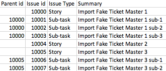

Here is how I was able to import Stories with Subtasks successfully.
For testing purposes, I kept the columns simple:
Parent id, Issue id, Issue Type, Summary
Jira only uses the Parent id and Issue id for mapping purposes so you can use whatever number scheme you want. For a Story, you leave Parent id blank. For a Sub-task, you use the Issue id of the Story. I still used an Issue id for the Sub-task.

I was able to import Subtasks using a similar process to the above.
The exception is for Parent id I used the Key to the Story.
The result:

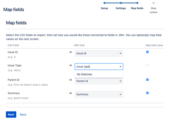

Thanks for the detailed breakdown. Quick question for you, are you using JIRA Server or Cloud?
We're on the Cloud instance, and I don't have the option for an "Issue Type" during the import. Do I need to configure something in the JIRA Settings?
My import screen also looks different... it doesn't include any of the comments about sub-tasks at the bottom.
Marek Dziedzic
November 29, 2018
After spending a day trying to figure this out, here is the solution.
First, confirm that this functionality exists on your instance:
  1. go to JIRA Settings > System > External System Import.
  2. Attempt to upload a file and confirm if you have access to Issue Type.
If you do, this means that your JIRA instance supports the ability to map issue type for a CSV import, but that your edit screen is not configured. If you do not see this setting, unfortunately I do not have a solution.
In the case that you did see the Issue Type in the External System Import tool, you can modify your edit screens to allow all users to add Issue Type during an import. To do this:
  1. Navigate to Project Settings > Screens.
  2. Click on Action in the top right corner and select Edit Screens
  3. Next to Default, click on the Screen Scheme link
  4. Next to Default (again), click on the Screen link
  5. Under the Field Tab, scroll to the bottom of the screen and add Issue Type from the Select Field... drop down.
You should now be able to select issue Type from the standard issue importer when adding tickets as a normal user.

Divya Reddy
February 12, 2021
Hello Team,
Can any of you please help me with bulk import of new stories with  sub tasks . I have tried exactly the same how @Jason Odra mentioned in his example but does not work for me. i see errors.
Thanks & Regards
Divya
Divya Reddy
February 12, 2021
@[deleted] Please need your help - Allow to create Parent Issue and Subtask in single import . I have tried the way you mentioned in above example but unable to succeed.
Nic Brough -Adaptavist-
February 12, 2021
Have you tried doing what was explained in the accepted answer?
Divya Reddy
February 14, 2021
Hello @Nic Brough -Adaptavist-
Below is the format of my csv file. I have made an excel first before saving as CSV. Can you please help where i am going wrong.
February 17, 2021
How are you mapping the parent id and issue id columns?

1) Create and Excel with Issue ID, Issue Type, Parent ID, Summary
2) Issue ID is the 6 digit number, Issue type is 'Sub-task' , PArent id is 'Issue key', Summart is 'What you want as Sub task'. Save Excel as CSV
3) Click on Issues drop down, select upload through CSV
4) Upload CSV, map all fields as mentioned above
5) And done
