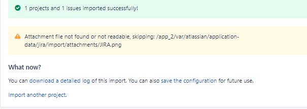

I uploaded the attachment on a shared location with the csv file which was supposed to be imported. Both the CSV file and image file were uploaded on the same location but when the import process was started it errored out as -
"Attachment file not found or not readable, skipping: /app_2/var/atlassian/application-data/jira/import/attachments/JIRA.png".
Just to mention the above process was tried with keeping the files on my desktop as well but it threw the same error.
Can someone please help to resolve this?
