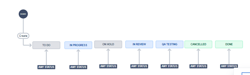

Tengo dos estatus diferentes de DONE, uno llamado DONE y el otro CANCELADO, pero cuando puse la épica en DONE no se desaparece del panel de épicas por algunos tickets que tengo Cancelados. Cómo puedo hacer que desaparezca mi Épica. Al parecer hay conflicto entre estos dos estatus.
Este es mi workflow y me es útil tener los tickets cancelados para llevar un control. Pero solo me desaparece la épica del panel cuando pongo todos los tickets en DONE. Qué puedo hacer para mantener mi estatus de Cancelado y que la épica desaparezca del panel cuando la haya completado?

I have two different DONE statuses, one called DONE and the other CANCELED, but when I set the epic to DONE it does not disappear from the epics panel for some tickets that I have Cancelled. How can I make my Epic disappear. There seems to be a conflict between these two statuses.
This is my workflow and it is useful for me to have the canceled tickets to keep track. But the epic panel only disappears when I put all the tickets in DONE. What can I do to keep my Canceled status and have the epic disappear from the panel when I have completed it?

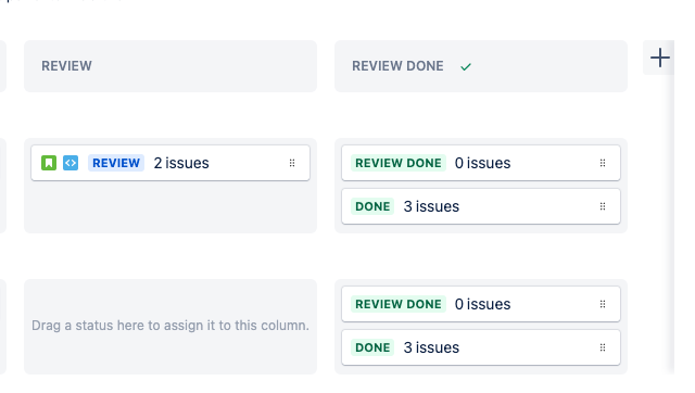

How are your Canceled and Done statuses mapped to columns? Does each status have its own column? If so, is it acceptable for your process to combine them into one column?
Based on my experiments, if you have the two statuses in separate columns then all the child issues of the Epic must be in the column farthest to the right in order for the Epic to be removed from the panel. If you map both statuses to that one column, then you can have your Epic and all child stories in any combination of those two statuses and the Epic will be removed from the panel.
That's right Trudy, each status has its own Column, and if it is acceptable in my process to be able to have both statuses, it is one column, but the question is, how can I change interchangeably between Canceled and DONE in the same column? How can I do that? so that some tickets have DONE status and my Tickets that no longer apply are set to CANCELLED
I'm not sure what you mean by change interchangeably between the two statuses in the same column.
The column will display all the issues in both statuses.
When you drag a card to that column you will see an area highlighted in that column for each status. Drop the card on the area for the new status you want to assign to the card. Or, when viewing the individual issue details you can click on the status button and select either of the statuses.
This requires that there be a valid transitions from the status the issue is currently in and the statuses in the column, just like any other transition.
Thank you very much for your help Trudy, you rock!.
With the suggestion you gave me, it works perfectly for me. Thank you
