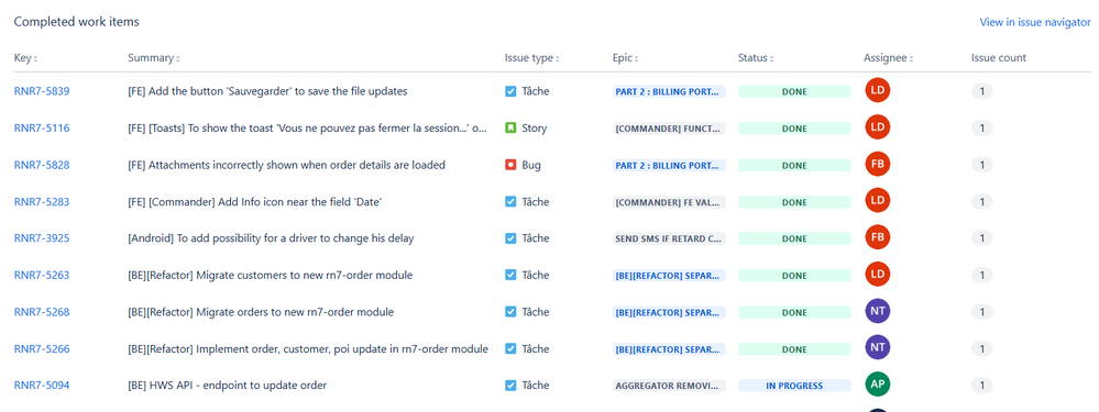

Hello ! I am in a team managed Jira and below the burndown chart, the completed work show In progress tickets, which is weird. thank you for your help jira burndown chart.png

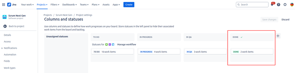

The Burndown Chart report considers as completed those issues that are on the last column of the agile board.
Perhaps you have an "In Progress" status mistakenly mapped on last column of the board?!
Go to your agile board configuration, under Column and statuses and check the status mapping for the last column. Make sure the "In Progress" is not mapped there.

my last colum is done and no in progress tasks are in this column, which is why I asked the question here, thanks !

Hi Septa, I would like to use the burndown chart but with correct data, in the complete work, I would like to understand what is finished during a sprint and what is not finished, and how the scope is modified, thanks !
