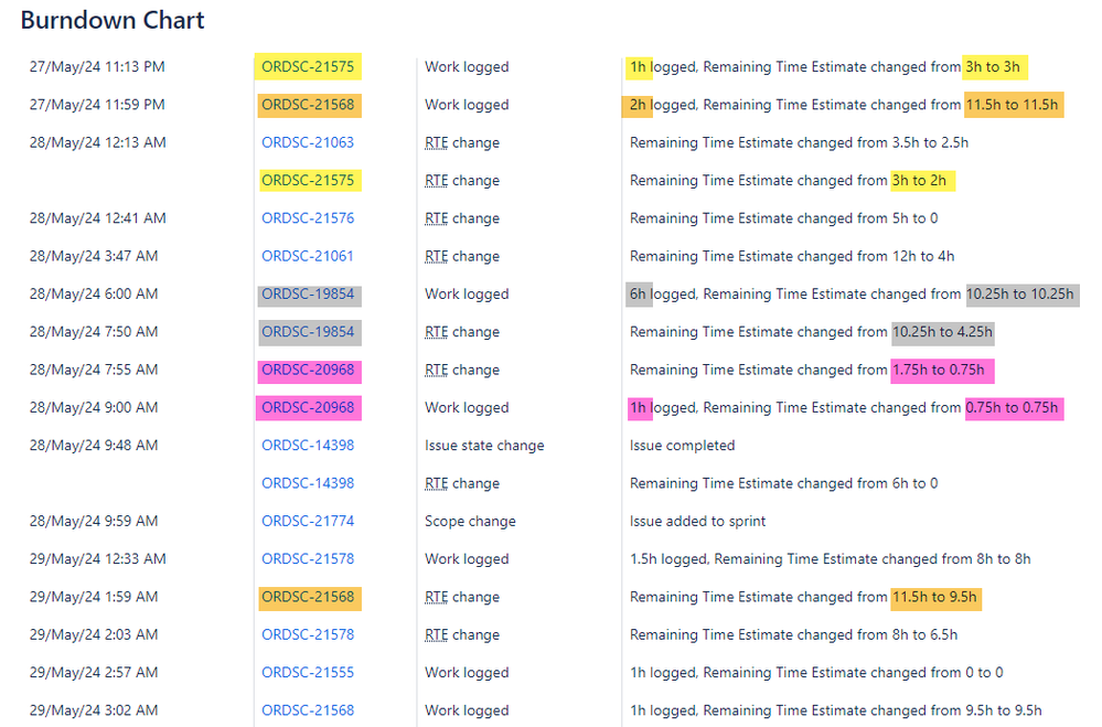

In my Burndown Report I see lots of entries like "4h logged, Remaining Time Estimate changed from 8h to 8h". The hours logged vary of course, but the Remaining Estimate doesn't decrement. If I look at the Estimate tab in the Issue I do see that the remaining time is accurate so it appears to just be an issue with the report. Any ideas?

The image below shows the problem I'm seeing. Time gets logged but doesn't change the RTE, Sometime later (or in one case earlier!) the RTE is updated. It's just weird.
