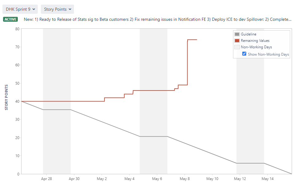

I haven't been able to figure out why our burndown chart doesn't show progress after reading other threads.
Burndown chart is configuring with Story Points. Tickets have story points and accurately show when they're added to the sprint:

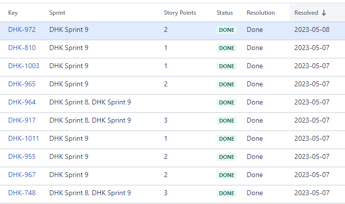

 Stories in that sprint are marked Done and have a Resolution, but they aren't reflected in the above burndown. image.png

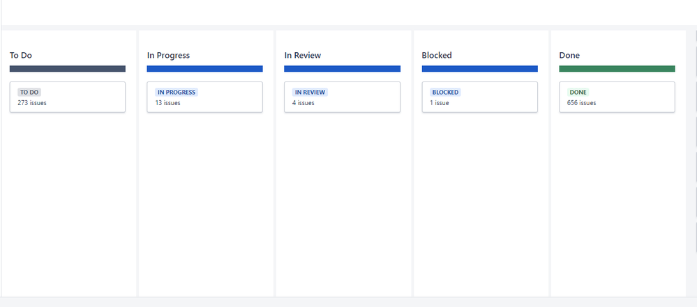

Done is the right-most column on the board

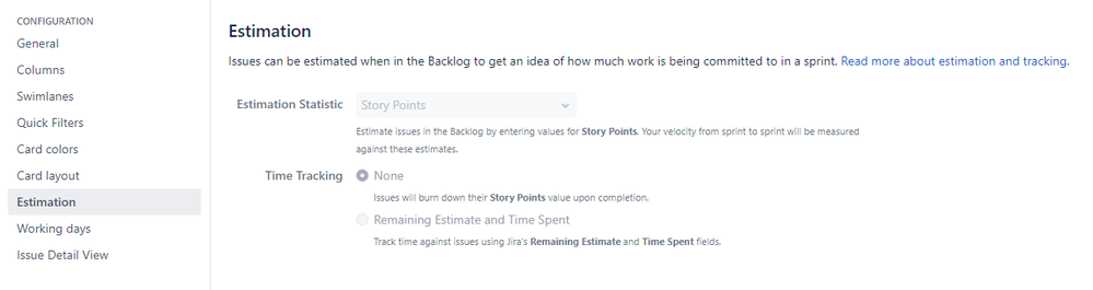

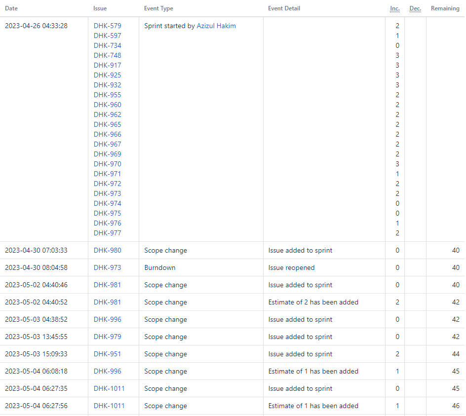

Below the burndown chart should be details showing how the scope changes as stories are added/removed/completed in the sprint and if the story point value is changed on an issue.
Does that table have any information about these Done issues?
The chart shows that your remaining work is increasing. Are more stories being added or story point values increased?

The table shows the done stories being added but none of them as closed, so the total story points is only increasing. image.png
But as you can see in the issue search screenshot above, some of those tickets in the table are Done (in the same sprint) even though they aren't reflected in the table.

There should be separate entries with dates matching the Resolved dates showing that the issues have been completed. Are those not present?

There are not separate entries in the burndown report's table that match the Resolved dates from the issue search. That seems to be the issue.
