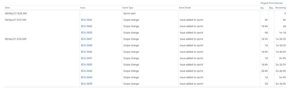

Mikela Vaillancourt
April 6, 2021
Hello so now that I created a new Sprint, here's the result i'm getting. We started working on the issues beginning of March. Is that the reason i'm getting a graphic like that?
Thanks!2021-04-06 08_40_42-Scrum Board - Agile Board - JIRA.png2021-04-06 08_40_29-Scrum Board - Agile Board - JIRA.png
Nic Brough -Adaptavist-
April 6, 2021
Both of those are saying you added a pile of estimated issues to an active sprint on April 6th.
I am not sure why you have done this, it is of no help repeating the same thing that broke your sprint report before.  As I said before: A new sprint, started after estimated issues have been put into it

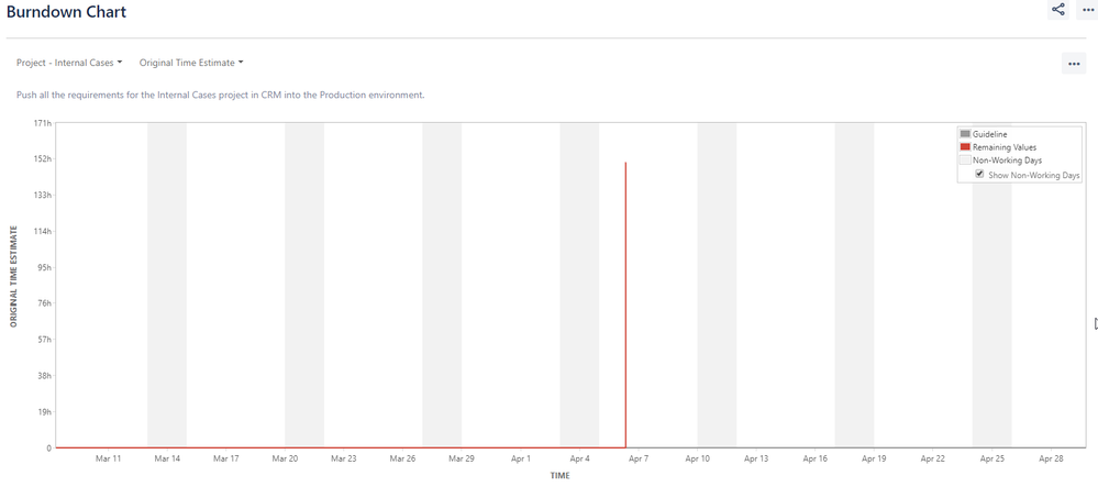

Mikela Vaillancourt

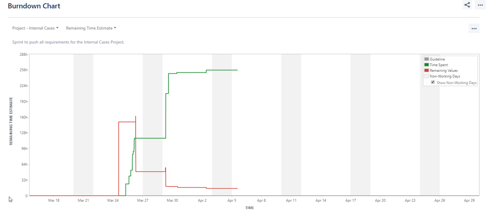

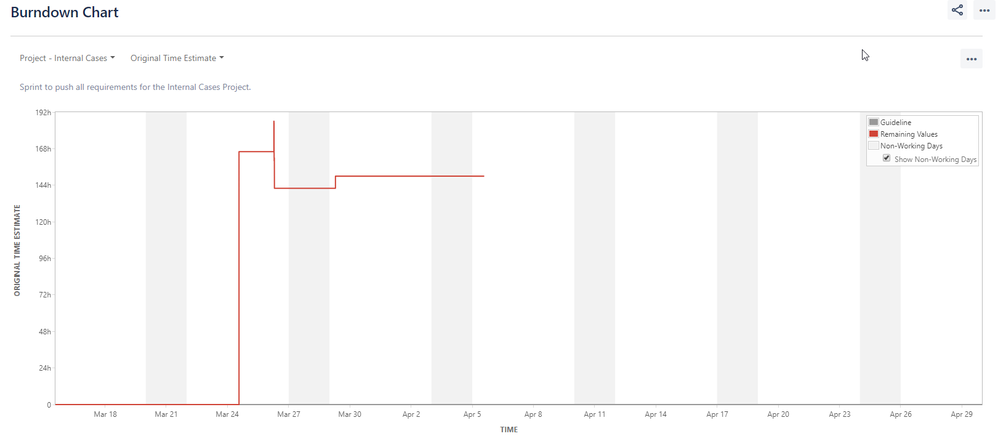

April 5, 2021
Hello, on my side I'm also facing similar issues.
See my two burndown charts attached. Why is it not possible to see the Guidelines Line on my chart?
And why is the Time Spent line on my second chart above the Remaining Values Line?
Thanks!
2021-04-05 14_04_58-Scrum Board - Agile Board - JIRA.png2021-04-05 14_04_20-Scrum Board - Agile Board - JIRA.png
April 5, 2021
This looks like you started the sprint with no issues that had estimates on them, then added issues with estimates into it, or added estimates to the items in the sprint.
As you started with a zero estimate, your guideline is there, it's just drawn over the x-axis - a grey line at 0!

Mikela Vaillancourt
April 5, 2021
Thanks Nic,
is there a way to show the Guidelines properly now? Should I delete my Sprint and do another one?
Thanks!
April 5, 2021
The guidelines are being shown properly, if what I've described is what you did.
A new sprint, started after estimated issues have been put into it, would fix it, yes.

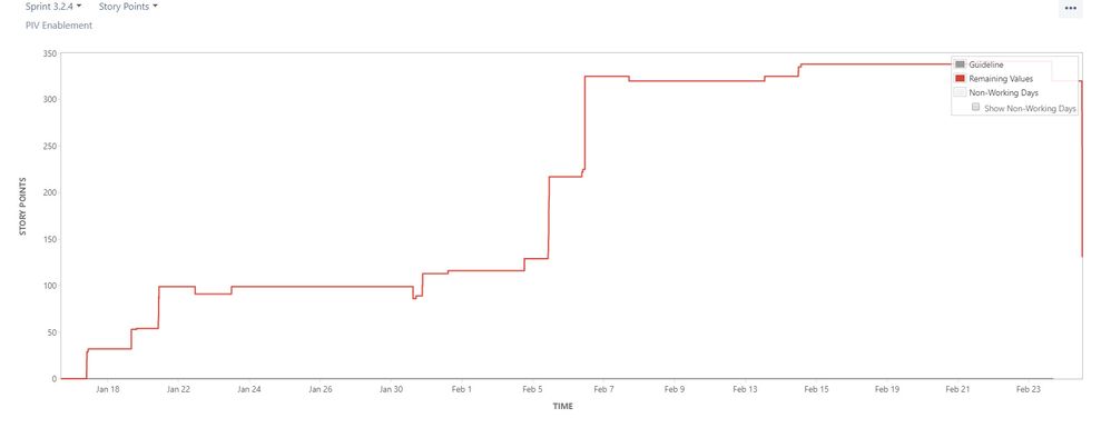

joan collantes
March 21, 2022
hi, what field should I put the estimate on it when creating a task? I've read somewhere the field should be original estimate? Also the burndown chart is showing story poiints, issue count and time and it showed somewhere that it shouldnt be via story points. I am having the same problem as this, its not showing the guideline.estimate.png
March 21, 2022
It should be the field that you've chosen to use for the board's sprint estimate.

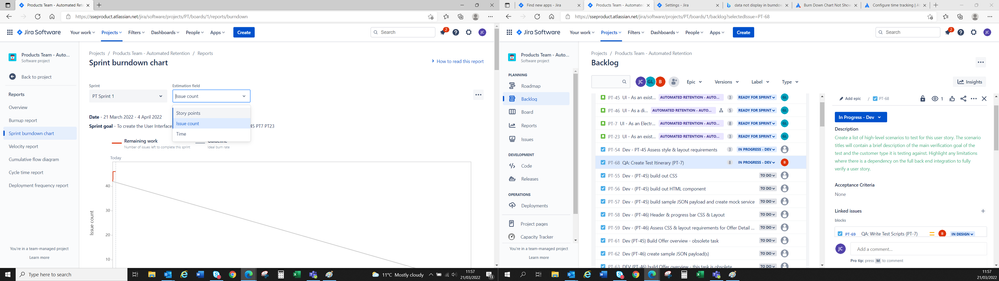

joan collantes
March 21, 2022
estimate.pngYes, i have an estimate as seen above. However my chart isnt showing the guideline as well. because the dropdown list (See first attachment) doesnt have the Estimate selection from it. Should Estimate be used or story point is enough to show the grey guideline

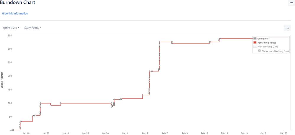

Tom Mastal
February 23, 2018
Update: The administrator changed the Time Tracking to None. Now the Burn Down Chart looks like this. Any assistance, is greatly appreciated.BurnDown Chart1.jpg
February 23, 2018
Looks to me like you are adding stories into the sprint (or adding points to stories in it) but never completing any.  Are you moving your stories into the far right hand column at all?

Thanks for the reply. No I couldn't move the stories to the far right b/c I work with a gov't entity and user story isn't done until it goes through a through security scan. That being said, we deployed over the weekend and I have moved about half of the user stories to the far right (which is Production) for our team. This is what the Burn Down Chart looks like now. It's still looking messed up.
February 26, 2018
I'm not sure what's wrong with it, could you explain?
It now has the line falling on the far right, as you've marked some stuff "done", so it looks right to me.

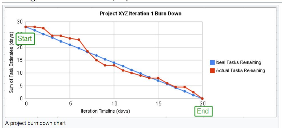

Tom Mastal
February 26, 2018
Nic,
I am more accustomed to seeing Burn Down Charts like the example I am showing here. Perhaps, I'm missing a proper configuration in how I track User Stories or something?
Thanks for any insight.
February 26, 2018
The burndown chart you would look like that if you had been moving the stories to "done" during the sprint.  You've moved them all at the end of the sprint and you've been adding points into the sprint during the execution.  The graph can only go on the information you give it.
