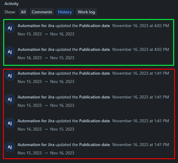

Thanks again for this! It's saved me a load of time with tasks that have only mentioned "the keyword" once. I was wondering if you knew off the top of your head if it's possible for a smart value or advanced branching to look at the first instance of a comment with the keyword and then stop. As what I'm experiencing is it updating single tickets back and forth a few times before ending up on the latest comment.

Chris Ripley-Duggan
November 16, 2023
That definitely improved the results! You'll see it only ran through and updated the ticket twice on the latest run, compared to the 4x earlier. I'll keep tinkering and see what I can do!
