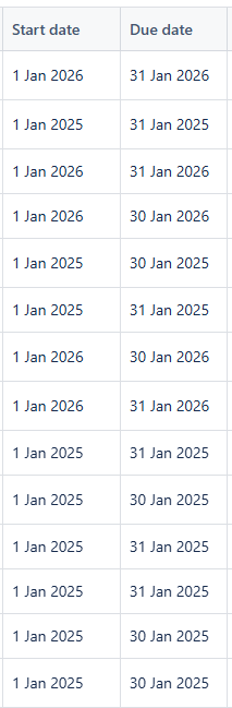

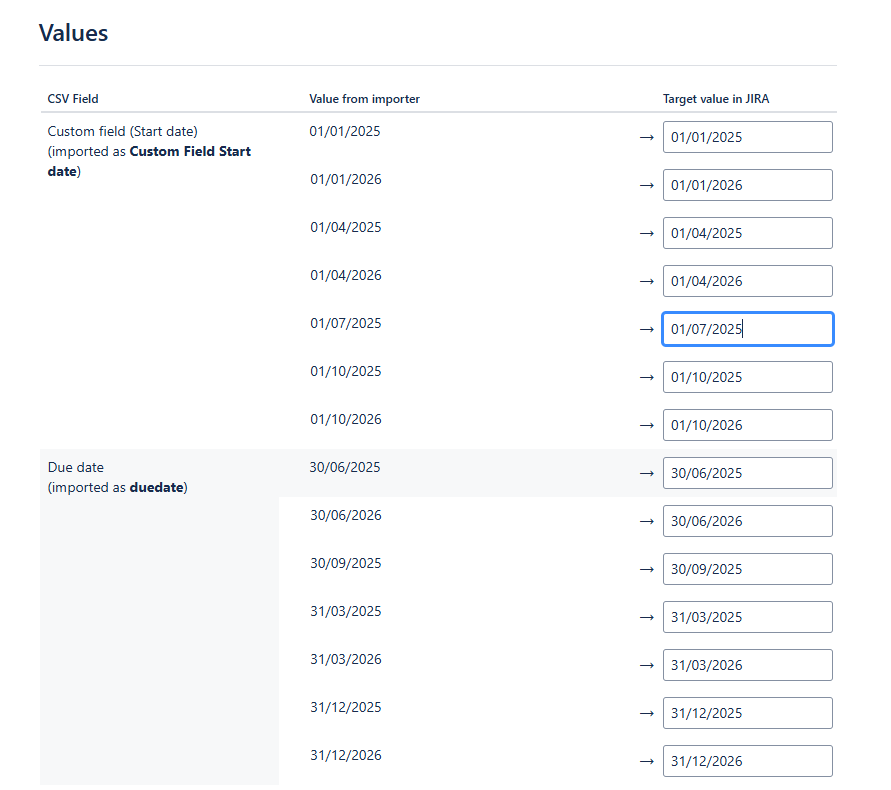

Below is a screen shot of the values that I should have seen uploaded i.e. standard quarter dates that I double checked.
But what I got was Jan dates for all dates. It appears to have ignored the Month part of the date and defaulted to Jan - which appears to be the pattern for Due Date.

OK - well that fixed it.
So when I imported dates in a format dd/mm/yyyy it lost the month and defaulted everything to January.  As can be seen in the table above in my first post.
When I changed the date format in the CSV and the corresponding import date format to be dd/MMM/yyyy it uploaded successfully.
While I have solved the issue for me, I would still think that this was a bug as it allows you to choose the simple date format of choice.  https://docs.oracle.com/javase/1.5.0/docs/api/java/text/SimpleDateFormat.html
