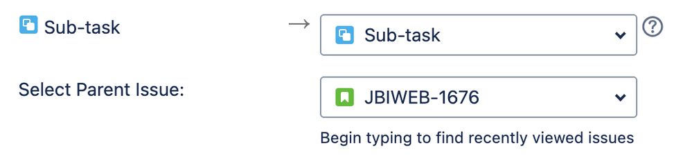

Why does Atlassian have;
Why is there no "Current Parent" option!! Logical isn't it?

I have the ssame issue as Maya. I create a JQL that returns only sub-tasks. I then bulk edit and select Move Issue operation. Then in next screen - Step 3 of 4. Select Projects and Issue Types - for each and every item in the query I am asked to select
Move Project A > Project Z
Move task type A > Task type B
Select Parent Issue: Parent issue 1
there is a checkbox saying "Use the above project and issue type pair for all other combinations." but if you select that the confirmation screen says:
Issue Targets
Target Project:  Project Z ( correct)
Target issue Type: Task Type B (correct)
Target Parent Issue: Parent issue 1 - NOT CORRECT ! .. I want each moved task to retain its original Parent and not have them ALL changed to Parent issue 1

@Nic Brough -Adaptavist- I also have the same issue and using Jira 8.5.3. Here is what I see:
I search and find 15 issues with issueType = Sub-Task and go to Bulk Change operation. After choosing all 15 issues with Move operation in Step 1-2, the next step 3 of 4 shows the following:
Step 3 of 4: Select Projects and Issue Types
You have chosen to move 15 issues from 1 project(s) with 1 issue type(s). You can either select a new project and issue type for each of the existing 15 combinations below or choose to move all standard issues to a single project and issue type.
Here are the available Move -> To options shown, with each of the 15 issues showing it's parent link:
  • Project - no change
  • Issue Type - I want to Move Sub-Task To Document
  • Select Parent Issue: - this shows the parent issue for EACH sub-task
I select the "Use the above project and issue type pair for all other combinations.", but there there is no way to "retain" the existing parent issue.
All issues are moved to link to the single parent issue from the first sub-task.
Is this a bug, enhancement, or user error?
