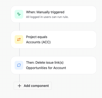

I am looking for a way to delete issue links of a particular type from a huge number of jira issues. Few of the issues have more than 2000 links.
I am using the below automation rule but this get stuck in In progress probably due to large number of links.
Any better solution/workaround to handle this would be great to know.
I also did not find an API that bulk deletes links from issues.

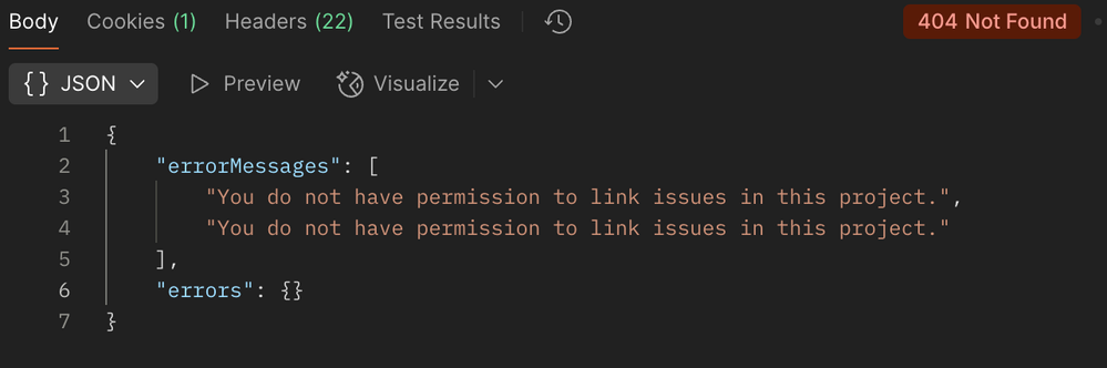

I tried that but I get this error despite having admin permission. Also, it is not mentioned which project is it referring to? I see nothing under "Body".image (3).png
Marc -Devoteam-
March 10, 2025
Hi @Priyanka Agrawal
No it requires you to have "Link issue permission" on each project in Jira.
So you need to be in the administrator role on each project in Jira.
