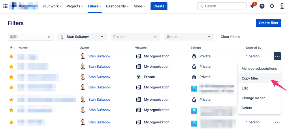

However you can improve the process a little. When you copy a filter from the filters list, it copies it with all the permissions, so it’s a little easier that way.
First you copy the existing filter:
and when copy dialog pops up, you rename it right there.
Once new filter is created (with the same permissions as the previous one), you can open it, edit the query there and save.
This is still unfortunately one by one process, but at least you don’t have to set permissions every time for every filter.
